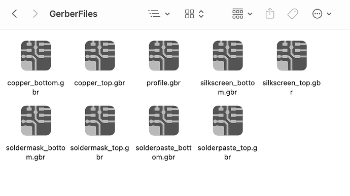

I have a Gerber file generated in Fusion 360. I would like to open it in kiad in order to change some footprint. Is the above possible?
Those are the files I have:
So I managed to open my gerber file in kicad but it seems not possible to edit it (?)

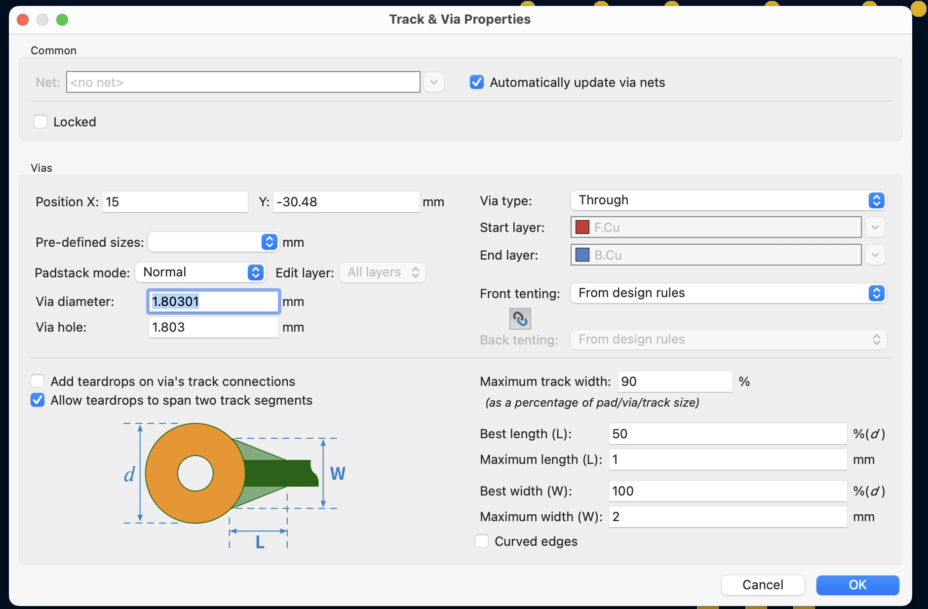

Thanks what should I do in this window:
Click on the (…) for each gerber layer, and choose the layer you want it to end up on in the Kicad project.
