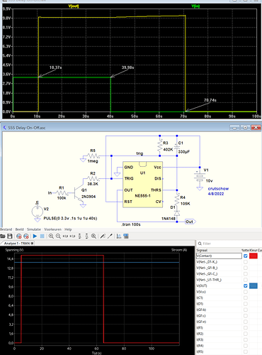

I have a schema (see here GitHub - johansmitsnl/kicad-555 ) where I have a 555 that should this behavior as in the top of the picture
What I get in the kicad simulation is the graph below which does not look the same at all. Now I’m asking why is it not the same because the V(OUT) should be delayed but it is not.
I used the library for the 555 from Simulation of 555 timer circuit in KiCad - #7 by Ste
Any suggestions why it is not working?

Your Eeschema output does not correspond to the circuit diagram.
Where is V(in)? What is V(contact)? Why are the voltage levels different?
You should show us only the KiCad circuit diagram.
Another trap we just can guess here are the pin assignments for the three devices (diode, U1, Q1). Are they correct?
Best is you zip and upload your project (including all ngspice models used).
Change your resistor R5 from 1m to 1M (or 1Meg).

The spice way is to use Meg, however when you use M, kicad will translate this to Meg for you when it creates the spice netlist.
The Idea is that you start with one of those working examples first. Then get to know ngSpice in KiCad a little bit better, before you start working on your own projects. There are quite a lot of subtle things that can go wrong in the interaction between KiCad and ngSpice. Differences in pin assignment is a very common problem (K & A of a diode swapped is an example). KiCad has a translation table to map KiCad pin numbers to the ngSpice pin (node?) numbers in the models. Another common problem is incompatible (or encrypted, whatever) spice models.
I think some work is needed on the design before trying simulation. Whether a monostable or astable, the output shouldn’t be fed back to the timing circuit. The timing capacitor should also be connected to gnd.

This was the solution, now it works as expected:
I did this but with my example I ran into issues. But it is now solved.
