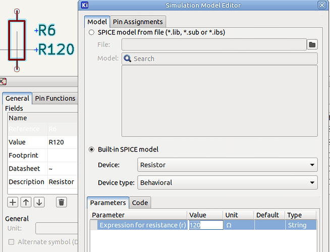

I just want to report back and send my thanks to everyone who replied with help.
I’ve now got the simulation working - after fixing the pinouts on the diodes you were right that the 120ohm resistors were not being correctly interpreted… I’m not even sure exactly why because with a value of ‘R120’ it seemed to be correctly (and automatically) setting the simulation value to 120 ohms but on one device it had the sim value as a ‘string’ type whilst the other was a ‘float’…
Needless to say, when I expressed the simulation value as 120.0 - it sprang into life and gave me the kind of results I was hoping for.
On the modification circuit I had managed to get the NPN and PNP transistors the wrong way around! A bit of tweaking + correction has got it close to expected behaviour.
Sadly it looks like all the spice models I can find for the 1N4148 diode and its common alternatives throw a parse error, which I think is due to some ngspice compatibility. However using a more generic diode is good enough for now.

Euhm, no.
Look at the RKM code link on Wikipedia I posted earlier. Standard interpretation of R120 is 0.12 Ohm.
Sorry - I didn’t mean to sound like I was disputing that… Writing R120 originally was a combination of me not paying attention and not being familiar with KiCad.
I agree that that I should have put 120R in the first place :face_with_open_eyes_and_hand_over_mouth:
I think what I did was set the symbol value to R120 but then edit the Spice Model parameters and delete the R on the incorrect assumption that it needed an integer value to pair with the ohm symbol in the Unit column:
i.e. I think I did this at first:
Anyhow, thanks to your kind and patient help I now understand how to correctly enter the values :smiley:
Yes, you can override the value in the schematic with spice directives, but it’s much less confusing if you do not use spice directives but directly use the value field in the resistor itself. That way the same value is shown and used both in the schematic and for the simulation.
