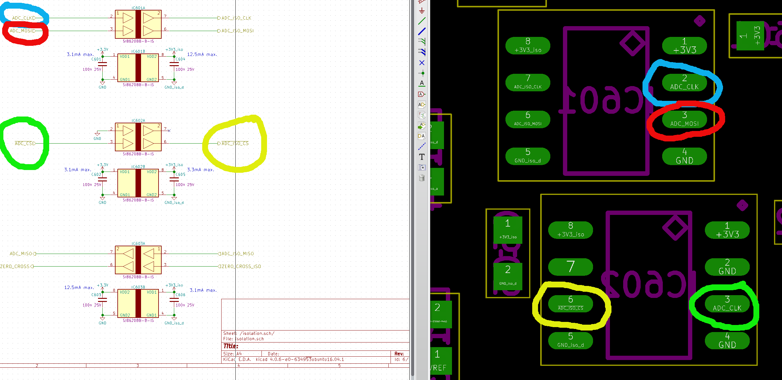

Netlist problem. Not a Bug
in this screenshot you can see the schematic and the corresponding pcb. Problem: The net ADC_CLK (blue) should be only connected to IC601(blue) but not to IC602(green). Pin 3 of IC602 should be ~ADC_CS which is not the case on the pcb.
Have you experienced this once? Is there a workaround?

Somewhere you have ADC_CLK connected to ~ADC_CS. In the case where a net has two or more labels, KiCad picks one.
The error is somewhere else on the schematic which you have not shown us.
Actually another possibility is that the PCB has tracks with the wrong net labels, this can happen if you move a footprint onto an existing track.
If I use Ctrl+F for ADC_CLK and ~ADC_CS I can’t find any unwanted interconnections. They are all connected with the pins I want.
On the PCB there are no tracks yet.

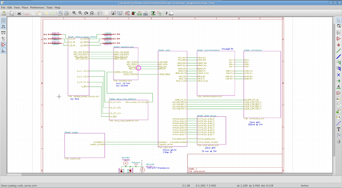

Found the problem. You have a connection in the main sheet:

Connecting 2 hierarchical labels from one sheet to another already fulfills your warning threshold.
In that case it’s actually 4 hierarchical labels labeling 1 net. If you would have local labels in those sheets as well (not to mention pin names) it get’s ugly pretty fast…
Errors like the one you produced are IMHO better catch-ed visually via net highlighting and a more powerful canvas driver.
Both of these are being worked on afaik, with nightlies already being able to highlight nets in EEschema.
Joining pins/ports happens. What should not be allowed is wires overlapping the hierarchical sheet box outline, as has happened here
