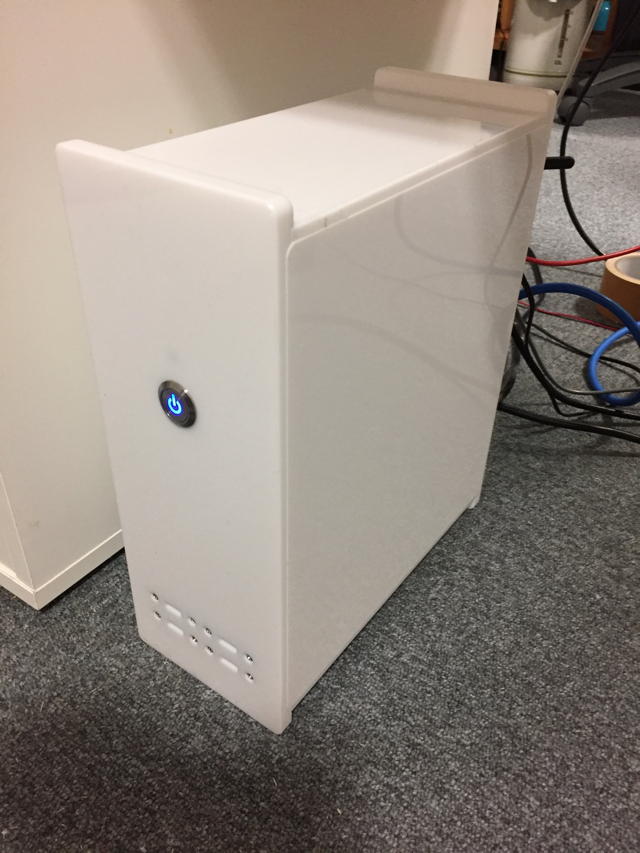

Just for fun: I also made a few PCs with minimal specs, 3 years ago. Low-end Core I5, mini ITX motherboard. Here they are:
  1. Cutting polycarbonate plates, 10mm thickness. The sides (5mm) are not shown, but they are just flat, with a few screw bumps for the side that holds the motherboard.
  1. Seen from the front panel. Note the 4 USB slots because there are never enough of them.
    2 USB2, 2USB3.
  1. Another thing: Normally a PC needs power for the PC itself, for the screen, for the printer, etc.
    All these peripherals can be plugged on the PC itself, therefore you need only one in the wall. You can notice that there is one incoming power cable and 2 outgoing (bottom of the PC).
    As you can see, there is no additional graphic hardware, and I think the board can support 2 4K displays. I will stay with a single one for a while.
Edit: I forgot to mention for the geeks: note that there are 2 serial ports. Not inserted at the time the picture was taken.

It doesn’t get that hot, because anyway Kicad doesn’t need huge computer power resources. The rear plate is not shown, but there are many holes in it for air evacuation. The air comes from the bottom fan. As I said, I bought an average mini ITX motherboard and a cheap Core I5. The memory is 16 GB, and I recently upgraded to a 1 TB SSD drive but it can work with 128 GB if you use Linux only.
For those who would like to build that kind of hard, be aware that the usual cable mess inside of a PC has to be tuned a little bit otherwise it doesn’t fit. I have shortened all the wires of the power 24-pin cable, and also the HD power cables. You can notice that all the wires have been cut, shortened, soldered and protected with thermo insulator. You can also notice the huge (and expensive) power button and the HD LED (blue) that can be seen on the front pane through the polycarbonate which is not completely opaque.
One more thing: don’t do that to save money because if you take into account the time you will spend on it, you could be more productive on some other task. I built that because I don’t like off-the-shelf cases which are built in food can technology. It’s OK for sardines in oil, not for a computer.
