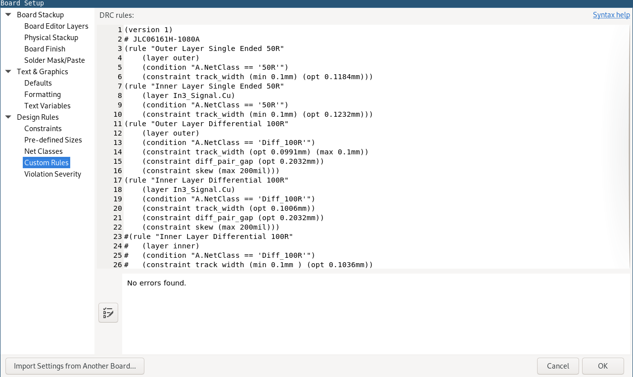

Setup more net classes ( after I changed my DDR schematic to hierarchical sheet, some of the net labels are seems to be incorrect named.)
Setup new custom Rules as the stackup
Route differential CLK_P / CLK_N
