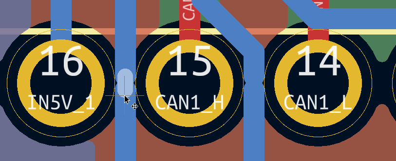

You have made a weird “neck down” connections around J2:
There is no need at all to do this.
