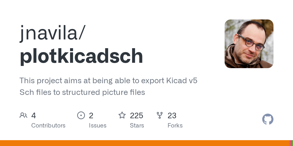

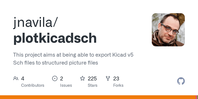

Diff comparison is not directly supported within KiCad yet, but there are a few external projects that might be of interest.
PlotGitSch
This project will render views of schematic revisions and can be used to show differences between them.

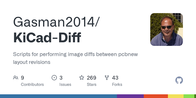

KiCad-Diff
This project renders pcbnew layouts as svg layers and uses a svg filter to overlay images and highlight differences in the pcb layout.

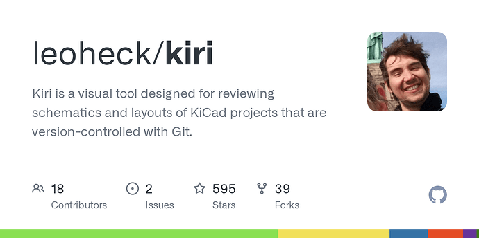

kdiff
This project is a combination of the two previous projects that allows you to switch between schematic and layout views and compares both of them.
There is a short video of this final tool on YouTube https://youtu.be/PMC0USSsbDE
