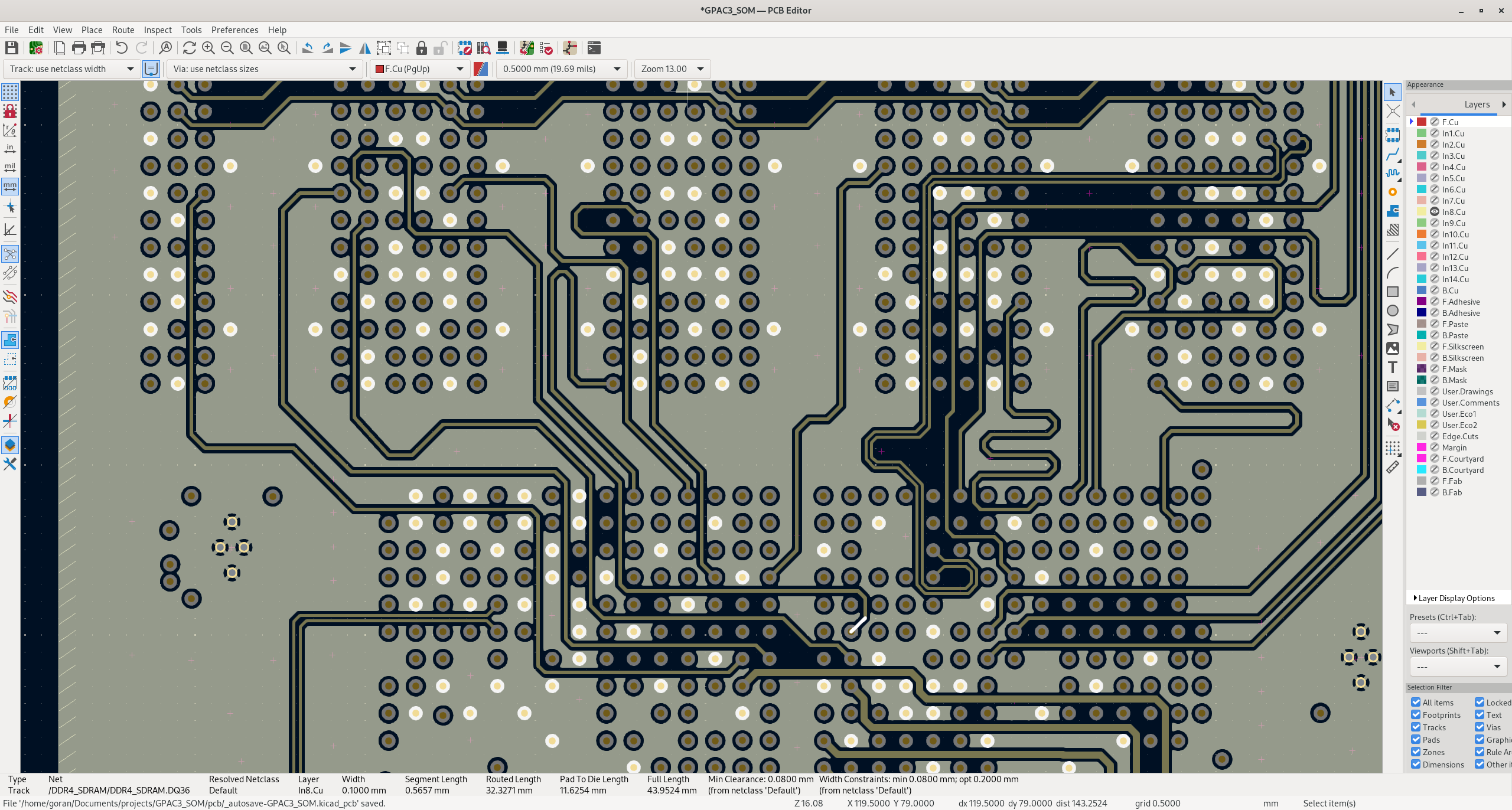

The way I do it for my FPGA projects is as follows:
The schematic is done as usual:
Then I add the on chip flight time to the package in a form which reflects the pad to die length:
Then routing: You have to make sure that the groups of signals stay in a comparable length:
Please note: The status showing the “pad to die length”, “routed length” and “full length”.
Keeping the length equal can be as well seen when you open the Inspect\Net Inspector.
If you group the signals in a spreadsheet tool you will see the length of the various traces… in my case I see:
And yes, its a lot of work getting it clean, equal in length, checking the capabilities of your chip to equalise bits… and so on.
Cheers
Goran

the GPAC2_SOM layout seems suboptimal for high-speed signals. if there is GND around the fast lines, it needs correct distance from to line to form a coplanar waveguide. and the GND polygon should have via connections to the next GND plane at every corner.
how did You decide the spacing to the GND polygon?
