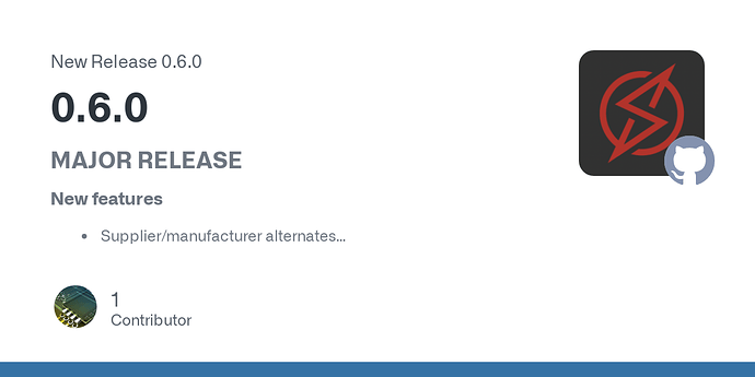

0.6.0 is out! :partying_face:
And a BIG shootout to the InvenTree team and their new website!
There is huge effort and community behind it, it is a very stable inventory platform with plenty of great features, so don’t forget to check them out, totally worth it!
