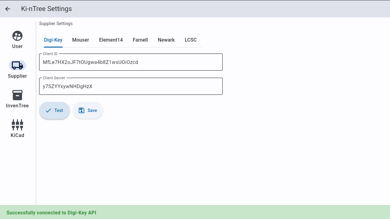

For anybody interested in the project, I am currently migrating Ki-nTree to a newer, nicer looking GUI framework called Flet: https://flet.dev/
I have released the first version (1.0.0 alpha1) :partying_face:
To try it out:
pip install -U kintree --pre
Let me know what you think!

The new UI looks very nice and works great.
I’m glad you like it!
I have just released beta1 which offers much more user customization for the part creation flow (most were previously hidden in the background…), check it out and let me know what you think :wink:
The 1.0.0 release is finally out! :tada:
Checkout the README for an updated demo video and info: GitHub - sparkmicro/Ki-nTree: Fast part creation for KiCad and InvenTree
You can update with: pip install -U kintree
I hope you’ll enjoy the new GUI and features!
