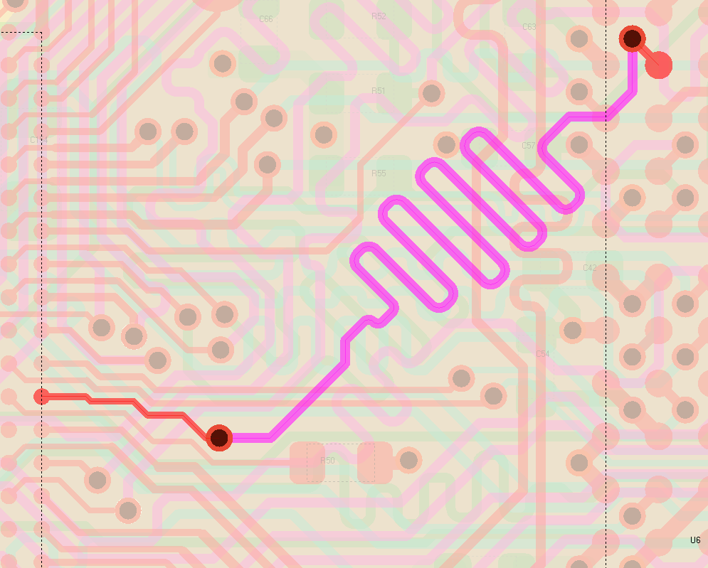

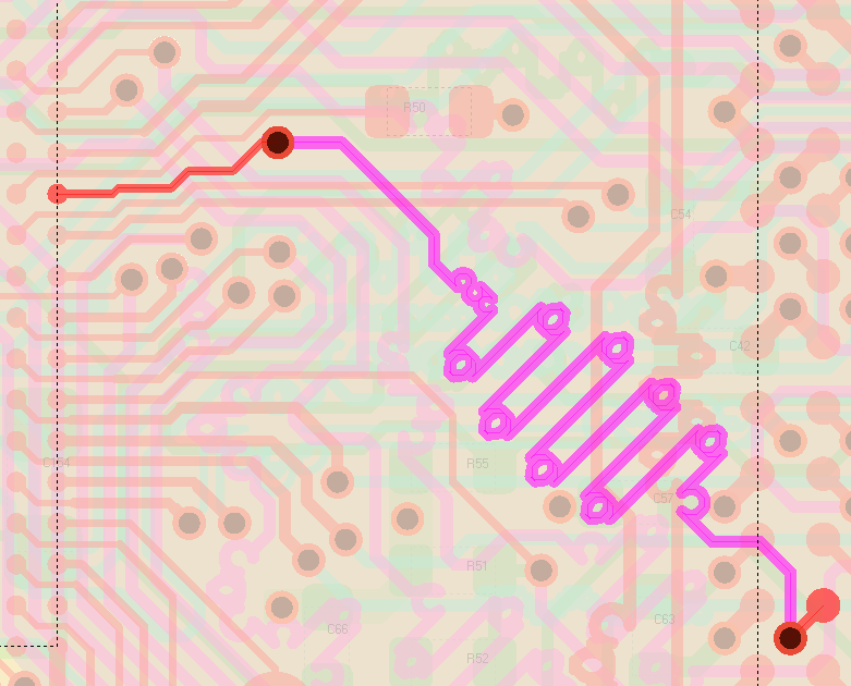

As shown in the image below, the kicad exported file(hyp) in the hyperlynx software is messed up.
Similar to the topic below, but I have version 9.0.3 with the same problem. Is there a solution for it?
It is possible to check in 9.0.4 ? Or create a small example?
The following version does not have this problem, but it has been Y-Mirrored!
Version: 9.99.0-unknown-5e6ef67fce~182~ubuntu24.04.1, release build
KiCAD version 9.0.3 was on Windows
Night versions are not stable, check in 9.0.4 if the error persists, you can create a request to gitlab
This problem exists in version 9.0.4
I also updated to version 9.99 and it also has the same problem!
Version: 9.99.0-unknown-fb558eee3c~186~ubuntu24.04.1, release

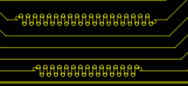

This looks very similar to a bug in the “fab 3000” software that was mentioned here years ago. There was a thread where even a PCB manufacturer joined in (I think it was JLC) and wrote something about using custom scripts to work around / fix bugs.
I wonder if these are all related in some way.
Apparently there is some ambiguity in the direction in which arc’s are defined.
