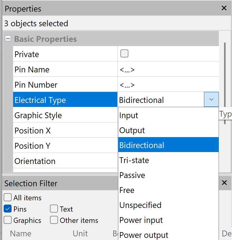

Dear Team,

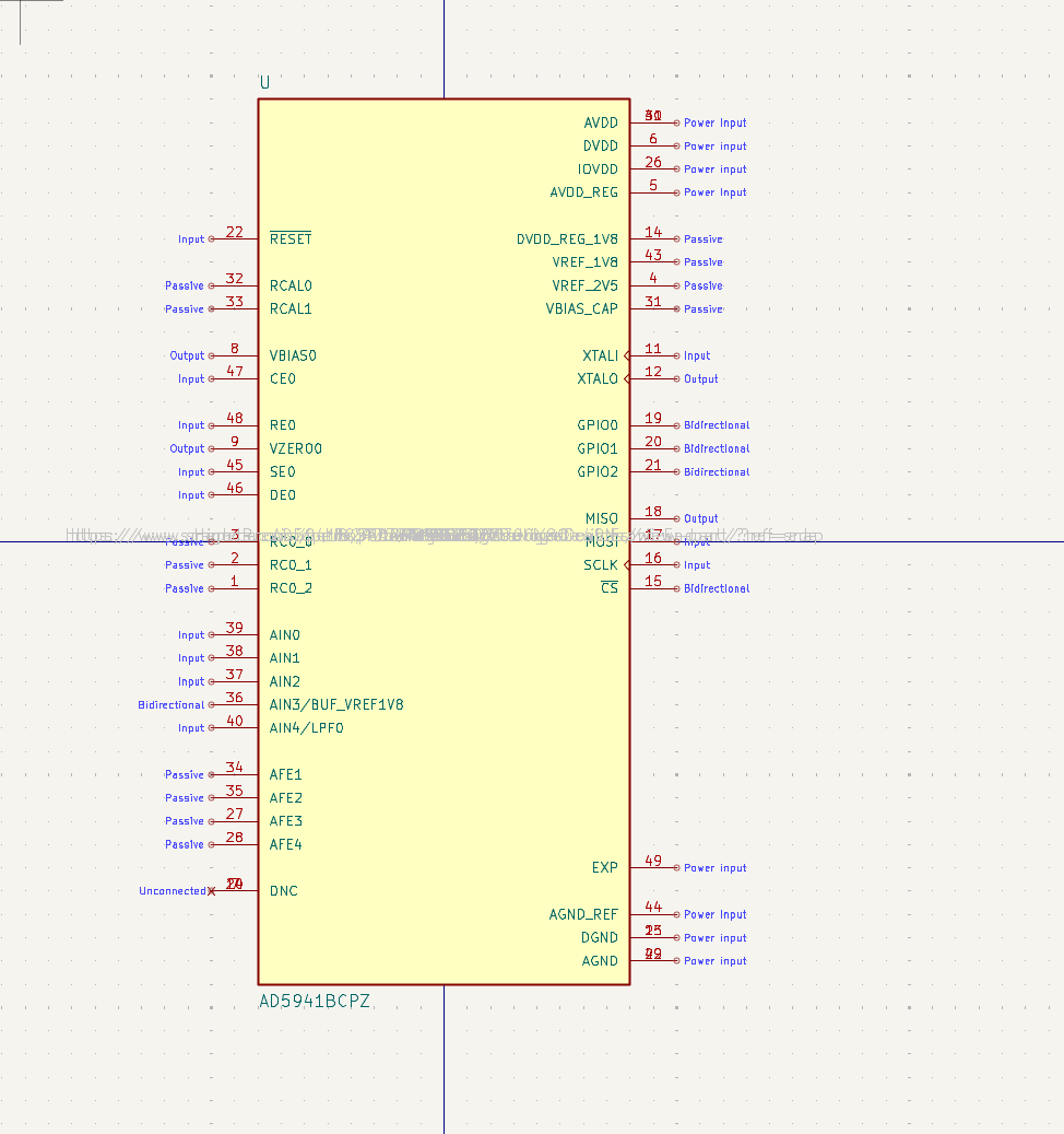

Below is my symbol.In this some pin type is IINPUT ,some are output etc.I need to change all of these pin type to passive.Now I am manually chaging all of this to passive.
May I know any method such that I can change in single shot.
First you have to have View → Panels → Properties visible. Then,
(Notice also the Selection Filter / Pins.)

AD5941 is not in KiCad’s default libraries and ERC does not work if the pin types are set wrong. As priotr mentioned, you get rid of all ERC message when you set all pins to passive, but it effectively also disables any ERC checks. “Passive” pins can be connected to anything without any ERC violation. When there are errors in pin types in a symbol then it’s usually just a few pins that are incorrect.

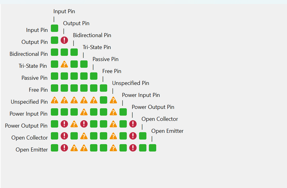

No. ERC does not gives a warning for that. Read the manual that RaptorUK pointed to (The same is under the Help menu). The Pin Conflicts Map gives a quick overview of the allowable connections.

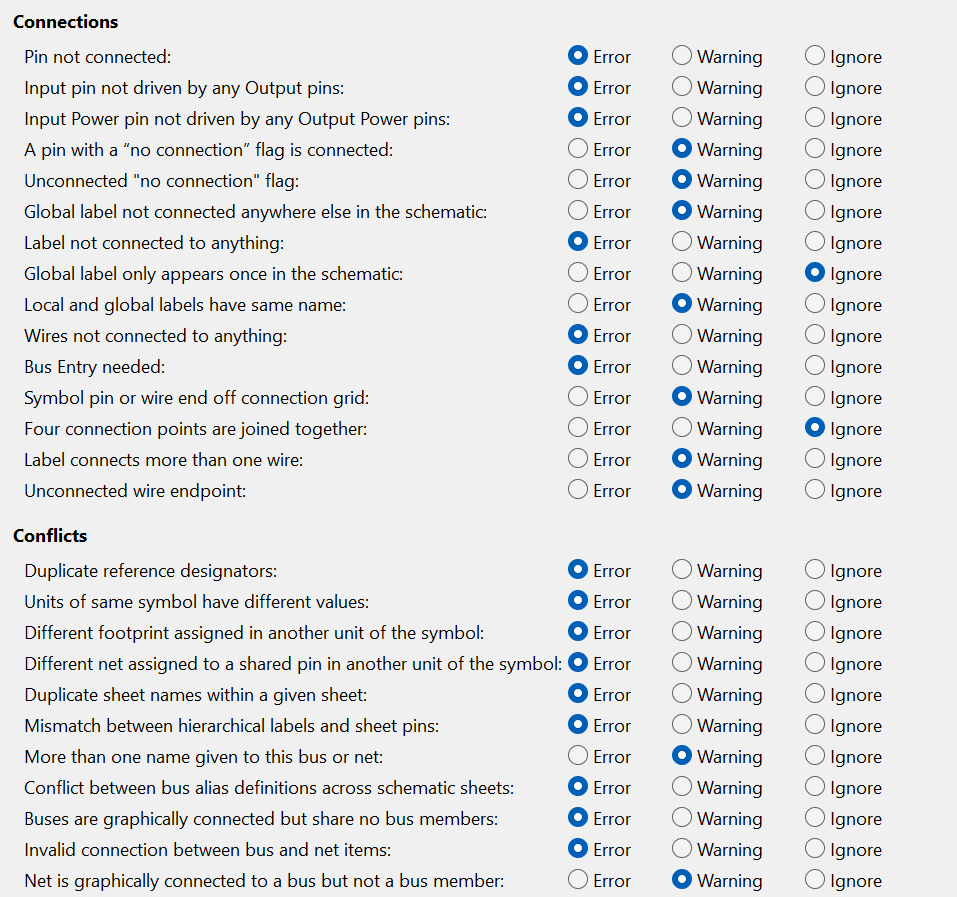

Below is my ERC settings may I know do I need to make any changes.I am using Kicad 9
It is only you, who can know this. It depends what situations you want to be warned about and what not.
I didn’t know ERC have so many settings :slight_smile:
May I know What settings have you found most useful in your experience with ERC
As Piotr already said, only you can know. There are so many settings exactly because KiCad can’t know what you need, and different users need different things.

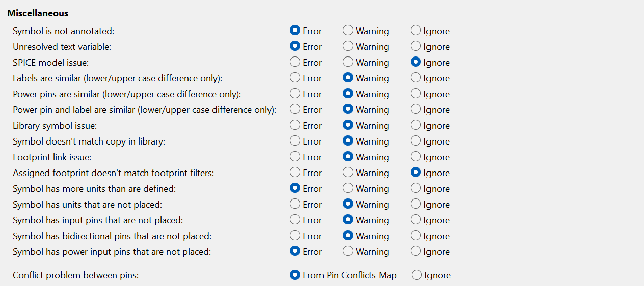

Have you already tried to read and understand the explanations? Schematic Editor | 9.0 | English | Documentation | KiCad
I can understand it’s not easy for a beginner, but if you do some research and can understand what each check does, you already understand large part about how the schematic and symbols work, and how KiCad Schematic Editor works. The experience may be invaluable.
As for me, I have never liked the pin types. They require not only understanding how the checks work and what the types mean, but also building the symbols and symbol libraries from the ground up with correct pin types, even from the beginning when you create your first symbols. This requires work you may not want to invest into in this phase. I haven’t used pin type checks, or turn it off if I notice complaints for symbols which don’t come from KiCad. (The symbols may come from existing old schematics, 3rd parties or must be made with strict schedule… I’m not Professional Enough to have worked in environments with quality standards for libraries.)
Let’s see, as an example, what you can learn if you learn to understand the meanings of some checks:
  • Symbol is not annotated – you know how annotation works (and of course what it is in the first place), it can be done manually, automatically, re-annotated…
  • Unresolved text variable – you know what are text variables in KiCad, how they work and something about how they can be used for your benefit.
  • SPICE model issue – you understand whether or not you need the simulation capability of KiCad.
  • Labels are similar (also Power pins, pin and label are similar) – you know that KiCad is case sensitive and that it can be problematic.
Etc.
Unlike some other things, the defaults here are pretty good. Maybe you end up changing just one setting for some special reason that only applies to you, but that’s about it.
For the problem of output connected to output, first of all the pins need to be set correctly to match the physical reality of the part. Then assuming that’s true, physical outputs will (almost) never track each other perfectly. There will be times when they try to drive different voltages, and fight each other. The result of that fight could be anything from “nice” current-limiting in both so you end up with an analog average, to complete destruction of at least one device. That’s why the ERC check exists.
