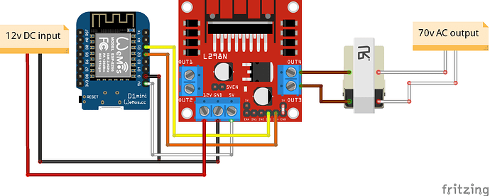

Actually during my ‘queste’ I found an even simpler approach. The most simplistic I found, is to use an H bridge at 12V or so. You PWM both IN channels to generate a square AC output of 12V @25Hz, if you put this output in a transformer and crank the voltage up to 70~80V than then phone should ring perfectly fine.
It may not be a sine, but ofcourse the sine isn’t the goal. A working phone is.
I thought I should try this first. It is relative easy to do before making a PCB.
Kind regards,
Bas
That was essentially the same idea. You can add a cap on the secondary of transformer to help round off the edges…
