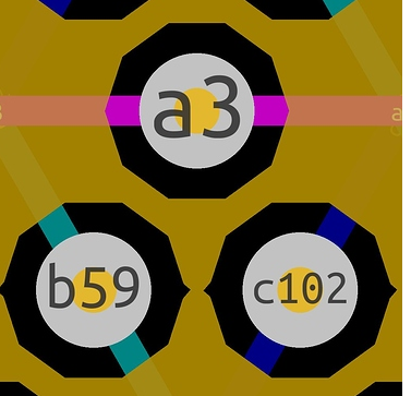

Huge file size GND layers. How to make 'Negative' layer plot (to Gerber)?
Thank you so much!
Ok. Returning to the OP, how do I make the “negative” from my ground planes?
Again, I am a newbie, so a level of elaboration will be appreciated :slight_smile:
That’s not possible in KiCad. Using negative plotting for gerbers isn’t a standard way to do anything, there may have been historical practical reasons to do that but not nowadays, and KiCad doesn’t support it. In any case it wouldn’t help if negative plotting would only reverse the “color” of the items because there would be the same amount of data.
If reducing the amount of data by using the new zone filling algorithm and simplifying the arc approximation didn’t help, I don’t think there’s anything else KiCad can do for you. KiCad export algorithms should be radically changed first to handle round holes in filled areas as flashes, or to draw them with arcs instead of segments.
But I’m still interested about the problem and possible solutions. However, you still haven’t provided much information.
  • How small you need the files to be (and why)?
  • How large/small they get with different arc approximation values and zone filling strategy (in 5.99)?
  • Can you still show a screenshot from gerbview where I can see the internals of the gerber file? Like my screenshots where the wireframes were visible?
  • Do you insist having negative gerbers only because of this file size problem?

I mean the “wireframe” like in the screenshot in my post above. Is it the simplest possible? If it is, there’s hardly a way to make the file any smaller.
In the end it boils down to “gerber code for one via” 115000 times. If one via takes, say, 250 bytes, it will be about 30 megabytes. That doesn’t include the overhead of everything else in the file. If you want to know the details:
  • Vias themselves are flashed, one via takes one gerber line:
    X173800000Y-86100000D03*
  • If you have so coarse zone filling that the clearance hole is an octagon, it takes basically 10 similar lines, 8 for the octagon and 2 extra for connecting the polygon hole to the rest of the polygon.
It’s even theoretically impossible to go below that with the current gerber generation algorithm. The only way by changing the algorith would be to replace the 8 octagon lines with one arc (which is basically covered by the wishlist issue above). Even using circular apertures with “clear” polarity for clearance holes wouldn’t then help much more.

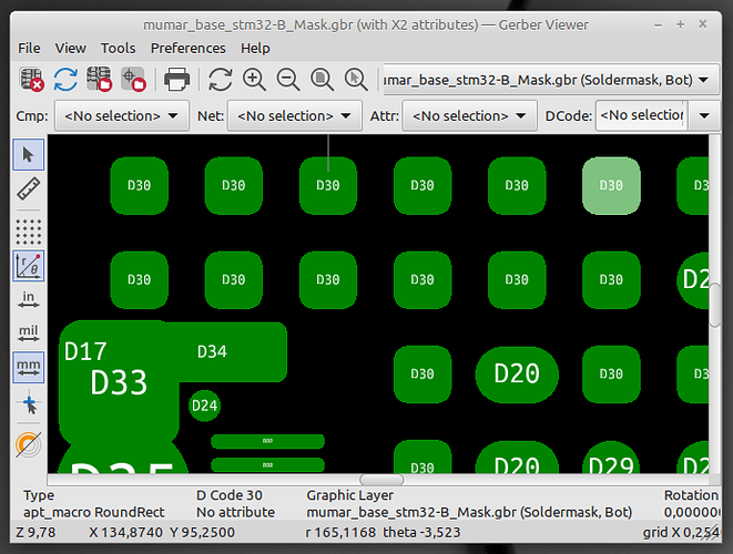

Sure, if you just define gerbers as being “negative”, then file size does not change. However, the idea about the ability to use negative features in Gerber results in being able to draw the things that are not in the output, instead of drawing the image itself.
Have a look at this part of a gerber file generated by KiCad:
It shows some defined apertures, which are then flashed on the solder mask.
First the apertures are defined, and after that each hole in the soldermask is just a single line in the Gerber file. Below is a small excerpt of the Gerber file, First is specified that aperture “D30” is being selected, and then a list of coordinates on which locations that aperture is to be flashed.
D30*
X137160000Y-96520000D03*
X139700000Y-96520000D03*
X142240000Y-96520000D03*
X144780000Y-96520000D03*
X147320000Y-96520000D03*
X149860000Y-96520000D03*
X137160000Y-99060000D03*

For each hole in the GND plane, the GND plane is directed around each via with a low poly approximation of a circle. In this case each hole is constructed out of 10 straight line segments, and thus 10 lines of Gerber code.
If it were possible to use the negative gerbers in the GND plane just as in the solder mask, then each group of 10 line segments could be replaced by one aperture flash. This will result in a reduction of filesize of 90% for all the via holes. And for 115000 holes that would save more then a million lines in the gerber file.
If file size is that important then you could hack into the files, either with a text editor or by writing a script, and then remove a lot of the internal structure of the GND plane, and replace it with the negatively defined features such as in the solder mask layer.
Normally via’s are covered by solder mask and therefore not in the solder mask layer, but probably are if you turn of the “tented via” option during gerber creation.
In your screenshots of the low-poly count circles, the GND plane between the via’s barely connects:
Whether it connects at all is of course a function of via diameter, via clearance, and distance between the via’s.
It is however also defined by the line widht that KiCad uses to draw the features on the GND plane, and in your screenshot that linewidth is apparently thicker then the available area, which results in the neck-down.
If this is a problem, it can be relatively easily fixed by giving the GND plane a little more room in that area. It can be done by either reducing the via size a tiny bit, or by reducing the clearance in the GND plane.

I also noted that in my posts, and it may indeed be important because it adds four lines for each via. However,
If the new zone filling algorithm is used – which should be used to reduce the file size – there is no “line width” for drawing. The old algo actually used segments (draw objects) for drawing polygon outlines, as can be seen in my post above with several screenshots. The new algo has just minimum width, but I think this may have caused bugs where the minimum width isn’t obeyed (https://gitlab.com/kicad/code/kicad/-/issues/7162, https://gitlab.com/kicad/code/kicad/-/issues/6907).
It’s important to check the minimum width in the zone properties and if the detail pointed out by Paul breaks it. If it’s wrong it would be important to add a use case into a bug report or create a new one.

I’m still interested: what is the zone minimum width, and how wide is that “neckdown” in the narrowest spot?
I think I got it here, about 120um neckdown. Between via centers is 0.9 mm.
But what is the value of Min. width in the zone’s properties?
It was 0.12 and when I reduced it did not fill anything at all.
