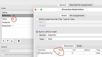

Below I show some options for consideration… beside’s using ‘Include’ and ‘sub-ckt’…
Screen Shot 2023-09-29 at 15.24.10

I was lucky to stumble upon this 20-page tutorial that was wonderful for my learning needs - simple, and clear. It’s not for Kicad, rather it’s for Command-line however, realizing that and spending 10-Minutes with Kicad’s NGspice, I learned how to implement it into Kicad…
ADDED: To help bring Clarity to Gosh Ex#1 with respect to it in Kicad…

@BlackCoffee – thanks for your contribution! That tutorial presentation is indeed helpful.
Your inclination to clarify using annotated screen caps and listings is very much up my alley and to my liking.
