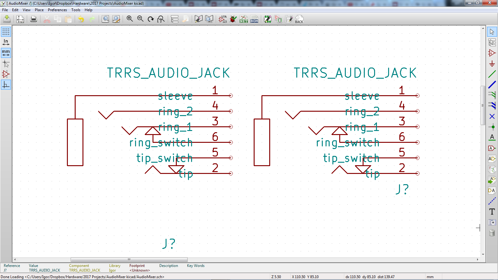

Neither closing and reopening the schematic editor did anything nor right clicking on the component “edit component”->“edit with library editor” did anything. In the latter case I tweaked the component slightly and saved it.
If I place a new component, that component is updated.
I forgot to move the reference designator back. (i know that at this stage i could just delete all the symbols and place new one, i just want to know for the future where this might be too difficult to do.)
Here is an image of the older symbol vs the new symbol.

Yes, the position of the refdes is overridden in the schematic. You can reset the label positions by going to Edit Component then click “Reset to Library Defaults”.
You must have a case of ‘same component in different libraries’ or similar… only the one that appears first is being taken and updated, not the other ones.
