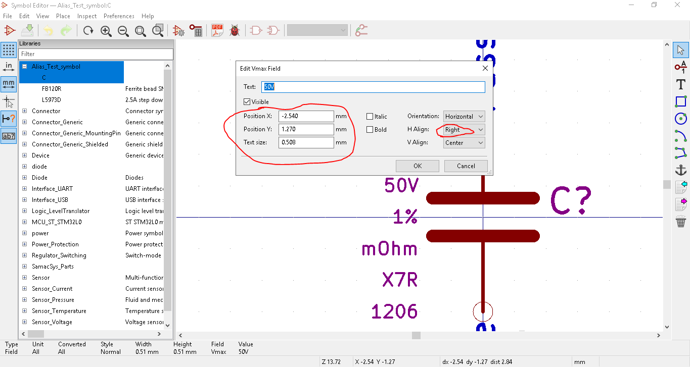

I created a symbol in the Symbol Editor and set the position of the fields according to my needs.
Then when the symbol is added to Eeschema, the setting made in the Symbol Editor changes. In this case the alignment and field position are different from what I set up in the Symbol Editor.
Is that correct? Is there any way to keep as I did in Symbol Editor?
Attached are the project files.
Test_Project.7z (2.0 KB)
Symbol Editor
Symbol Editor
Eeschema
Fields are auto placed in kicad. Otherwise one would not be able to rotate or mirror parts (Only other option would be to be able to define all 8 or so different positions for fields. Which would be quite a bit of work for every symbol.)
This can however be turned of in the settings for eeschema: preferences->preferences->eeschema âautomatically place fieldsâ

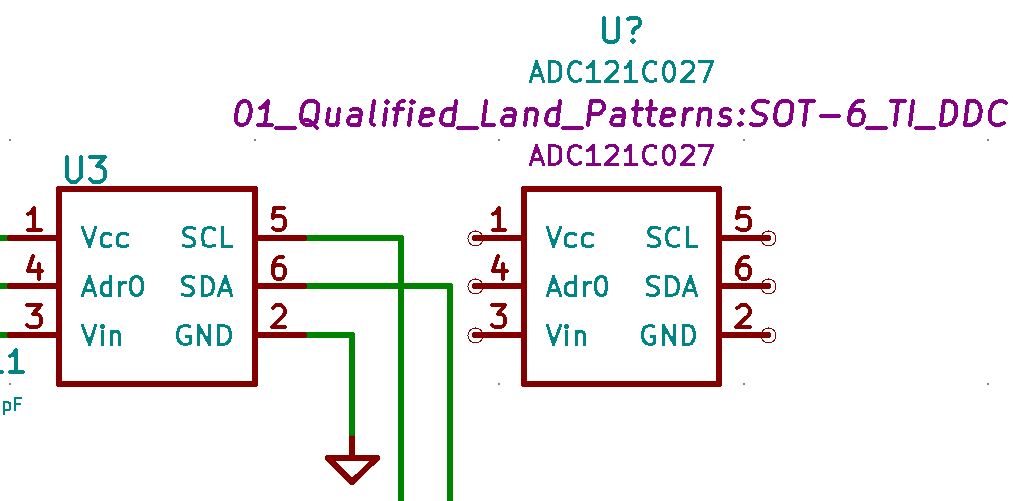

@Rene_Poschl I have done the same steps (I think) and I once again have the same problem, and this solution is not working on my design.
For several parts I have already, "Changed the Symbol in the Library to add the MPN field, deleted the Symbol present in the Schematic, then added the same library part back into the same Schematic.
ON EDIT: A few more snips from my side of the screen.
ON EDIT: I dorked up this post somehow, take II coming next.
What exactly is your problem here? What did you expect to happen vs what happened? What actions did you take? In what order?
I guess I made it less obvious than I thought, when I was trying to make it more obvious. DOH!
In the symbol on the left, assigned U3, it does not show the MPN field even though the âshowâ box is checked.
The schematic shows the exact same part, without annotation, and the MPN field displays as normal.
Every IC symbol in my schematic has the same quirk. The only way to get the MPN field to actually show is to delete the existing symbol and re-add the exact same symbol.
Aarrrgggghhhhh!!!
Well, I figured it out. Somehow those fields got placed OUTSIDE of the page drawing area.
At the moment I can not duplicate this, but before I took the screengrab, the text was NOT visible at all zoom levels. After I took the screengrab the text stopped itâs vanishing act.
