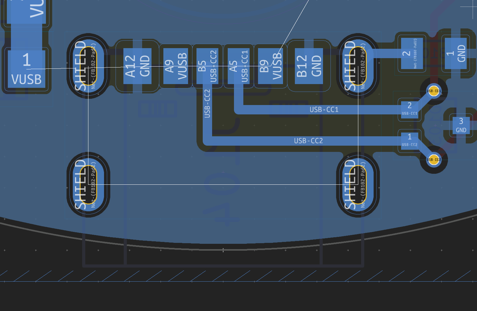

How to specify in footprint that connecting one pad satisfies all others?
I’m wondering if there’s a way, in the footprint editor, to specify that only one pad, of all that share the same name/number, must be connected.
For example, this USB connector’s shield has four pads. Electrically, only one pad must connect to the ferrite, which is tied to GND.
When I connect one of the four pads in the PCB, airwires remain on the other pads unnecessarily. I could leave them unconnected and ignore the DRC warnings, but it seems like there should be a way to indicate in the footprint that connecting any one of the pads is electrically sufficient.
I understand that pads with the same name sometimes must all be routed (GND pins for example), but for shield pins, this is often not the case.
Does anyone know if this is currently possible in KiCad, or should I file a feature request?

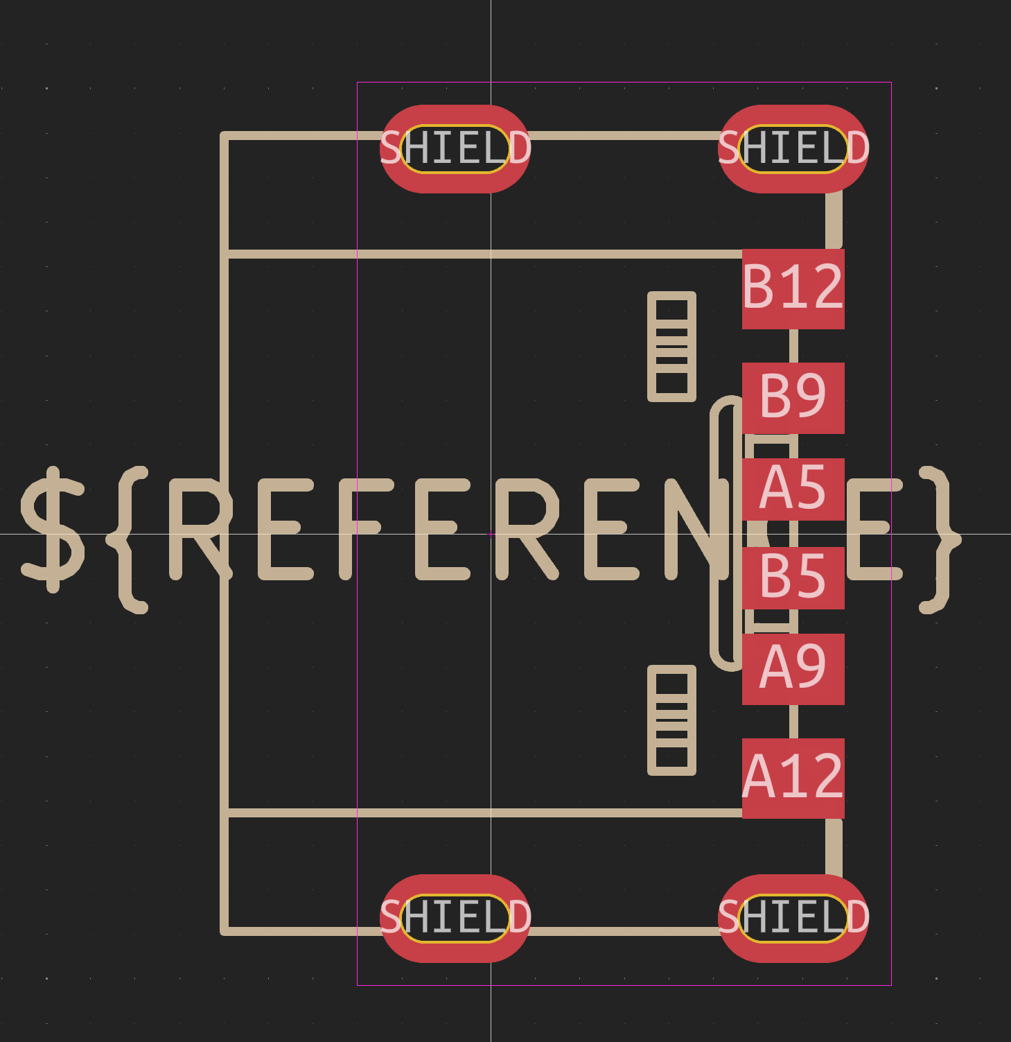

The pads are named/numbered the same (“SHEILD” using the “Pad Number” field).
The thing is that I don’t want them to be required to be connected together as they are already internally connected by the component since it is a shield. Only one pad needs to be connected, after which the airwires on the other pads should be satisfied.

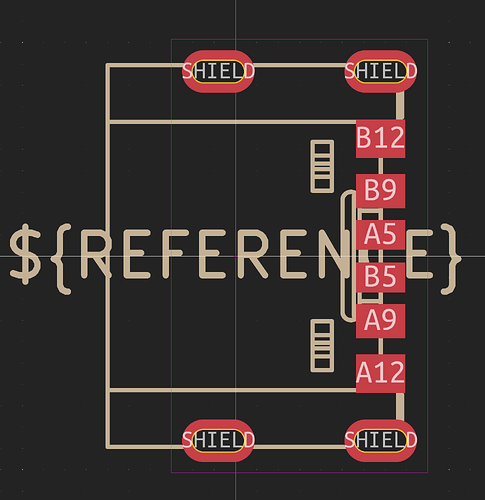

Here is a screenshot of the footprint, showing they all have the same “Pad Number” which is “SHIELD”
my bad, i remembered different (have not tryed)
'tis an FAQ. The answer is “not yet”. But it’s in the next version of KiCad! The new feature is called “jumper” footprints, referring to the part itself acting as a jumper between the pins. Check out the links at the bottom of the linked post for further discussion / use cases.

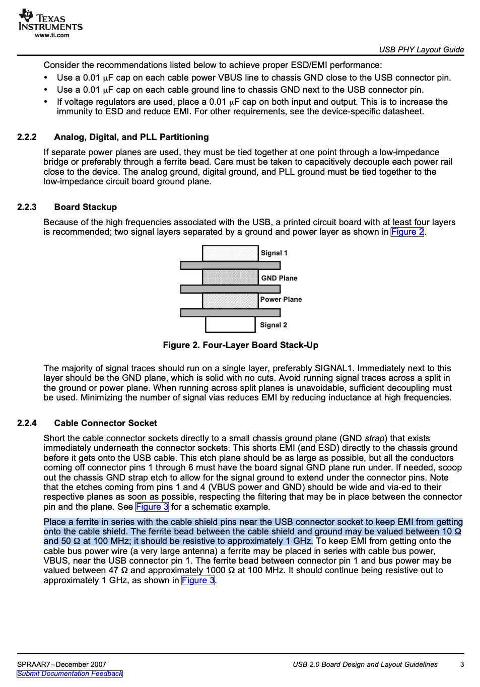

The official USB-C specification (as mentioned in that thread) does state that “Shield and GND grounds shall be connected within the USB Type-C and USB 2.0 Micro-B plugs on both ends of the cable assembly” and I am not suggesting otherwise. I am connecting Shield and GND through a ferrite.
This is a common technique suggested by a number of application notes. Here’s one from TI in SPRAAR7, see the passage highlighted in blue:

I’m having difficulty in believing that TI AN.
So you add a ferrite bead. In between what nodes are you connecting that ferrite bead?
If the ferrite bead “Prevents EMI from getting onto the cable shield”, then all your EMI stays on your PCB, and it has to be manage by the GND and signal wires, which is very yuck.
I’m not an USB expert, but I do know that there is very stubborn faulty practices “out there”. And that (unfortunately) includes application notes.
My gut tells me you’d want the lowest impedance possible in your GND lead between your USB device and the host (PC). That way, your whole cable assembly and USB device may work as an antenna, but there will be no EMI / signal differences between the plug and your device. And whether RF signals are coupled into this antenna, depends on what the host (PC) does. and those USB port shields are very likely hard grounded over there.
But this is a KiCad forum, and not an electronics design forum, so I’ll leave it at that.
Think of ferrite cylinders that many cables have on them near their ends. They work for all wires including cable shield.
They really help reducing EMI even thinking your way “all your EMI stays on your… device, and…”.
This works like CM choke. If you don’t want to have such big cylinder you can get partially similar effect by inserting ferrite beads in all wires (including shield and GND).
Yes, but OP has a ferrite bead between the shield and the GND on his PCB. The shield will have a lot of capacitive coupling into the cable conductors, and a single ferrite bead in only that location just seems like a bad idea.

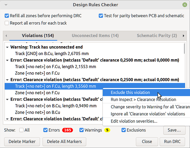

Just remember that DRC is just advice. You as the designer can choose to accept warnings and errors, as long as you understand why you did it. In this case you could add a text note on the schematic to explain why this was done.
Aditionally to davidrsb’s remark.

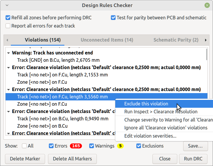

You can also exclude specific DRC violations by right clicking on them:
In the latest and greatest KiCad (I’m not sure whether it’s already in V9, or only in the nightlies at the moment), you can also add text notes to why a certain DRC violation has been excluded / ignored. Goal is so that the person who maintains the project over a few years can make more intelligent decisions. By putting such things in the DRC system, you don’t have to clutter your schematic or PCB with all sorts of remarks.
