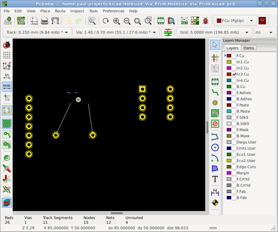

However, I also did a little experiment and changed some dummy board to 6 layers.
All THT holes are shown as long as at least one of the copper layers is active.
Here a screenshot with all layers turned off except “In3.Cu” and all through holes are shown just fine.
And this is of course as expected, because in KiCad the THT components have pads on all layers, also the inner ones:
So now I’m curious:
How do you turn the THT pads of is it is not with the “Turn pads off” button on the Items tab of the layers manager?
