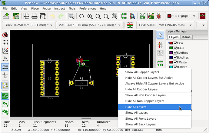

How’s that different from my second screenshot? Density isn’t relevant, the principles are the same: I have some SMD components on the bottom layer (net ties in the screenshot) and THT components on the top layer. I can see the bottom layer and the THT pads even though the top layer is invisible and the bottom layer active.
Wait a second, maybe this is the key. Do you mean “disable so that they are completely ignored and not selectable”? In that case what pedro just suggested will do the job. You can even easily open the context menu on top of the layer manager and click “Show all back layers” which also disables all front layers.

I think what you want is turn Layers off, not Items.
With the right mouse button on the layers manager, you can change the settings of multiple layers with 2 mouse clicks:
You have already discovered that your micro via’s and blind vias are not drawn if you disable the layers they are on.
I think you are close to the behaviour you want if
[RMB] / Hide All Layers
[RMB] / Show All Back Layers
From there you can more refine which layers you want to view by clicking on individual checkboxes.

Thanks Pedro. I got sufficiently close using your suggestion above. Thank you to all other contributors too.
That also works a treat and is a single-click version of Pedro’s approach. I think we have a solution that works. Thank you.
No no, the “single-click” solution is just Show All Back Layers because it also hides all Front layers. So you can switch between front and back with Show All Back Layers and Show All Front Layers without Hide All Layers.
