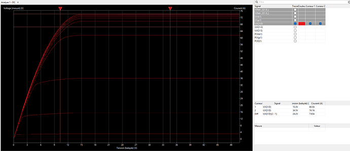

I use KiCad9.03
I can’t change curve with the cursor in dc double sweep analysis simulation.
Unable to take measurements except on the last curve.
It seem that it’s not possible to choose the curve !
Thanks for your help

Unfortunately this seems to be true.
You may open a wishlist issue at Issues · KiCad / KiCad Source Code / kicad · GitLab to ask for such a feature, best together with an idea how this choosing should be accomplished by the user.
Btw., the device at cursor 1 crossing already dissipated about 650W. This operating point is probably impossible for a power transistor, as you cannot get rid of the heat thus generated.
Thanks a lot for your answer. I m going to open a wishlist issue.
