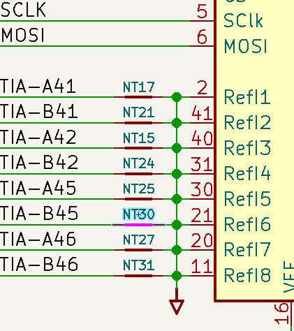

This caused my heart to skip a beat as I’ve made use of inner layers netties (in a hacked/kludgy way) on a few KiCad design now. I just loaded one into 9.0.3 and my inter layer netties show up fine in the layout editor. One of them on layer 3 is highlighted below in the attached image.
What was ‘invisible’ was post the hand-hack, nothing would show in the footprint editor, not the PCB editor and it was this way prior to V9 too.
L3NettieA

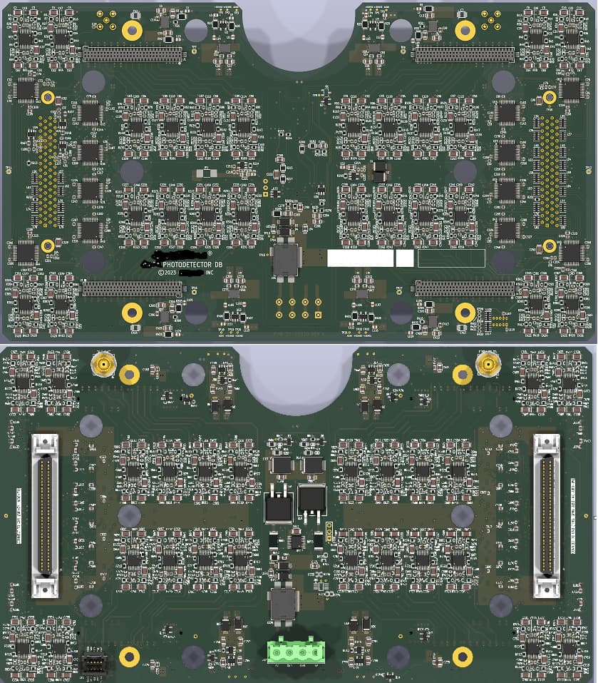

However, for very low level, low frequency, sensitive analog signals, over some distance, there’s exceptions. The snippet I showed is from a design that has (96) large area PhotoDiodes feeding (96) TransImpeadanceAmplifiers followed by (96) LowPassFilters. The signals from these can be small (mVs) and need to include zero. (bipolar PSs.) The impedance of the low noise precision TIAs is very high and the signals are very low so I also use guard trace moats sans solder mask as pAs of leakage current can matter at a JFET TIA front end. The frequency of interest for these signals is DC to 10kHz with a steep LPF at ~12kHz.
All the above circuity is on a separate PCBA sandwitched to another PCBA that has the snippet that I showed. The signals named LPO… is the output of the LP filter and the TIA… goes back to the TIA ref. These signals are routed like diff pairs for minimum loop area and maximum CMR. (If I could get the PDs and TIAs on the same PCBA and very close to the associated PGAs, maybe a different story, but with a densely packed array of large area TH PDs, coupled with product packaging that called for Z axis PCBA stacks, there wouldn’t be a single common ground ‘plane’ anyway)
The component shown in the snippet is an 8CH ProgramableGainAmplifier and I have (12) of them to get the (96) channels. This PGA is also mostly a low frequency, small signal bipolar powered analog device, it just has a SPI buss for the programable gain aspect.

A 4-wire Kelvin connection is a great example. I tried to not describe my snippet example as a ‘star ground’ but rather a ‘star connection’. It’s not so much a ‘ground’ connection as it is a voltage reference connection, that happens to be at zero volts DC. Just like the sense wires in a Kelvin connection carry negligible currents and are sensitive to tiny voltages, if you keep them length matched and closely coupled (like a diff pair or twisted pair), then they’ll reject common mode noise and influence.
Now imagine you have say (96) sense line pairs you want to have Kelvin connections to a remote downstream device or DUT on a dense double loaded 8-layer PCB. It would be real nice to have those sense lines and make those (192) Kelvin connections on the inner layers, In fact it could be argued that those Kelvin connected twisted pair sense lines carrying tiny currents could be best served on the inner layers and that’s the best place for them.
