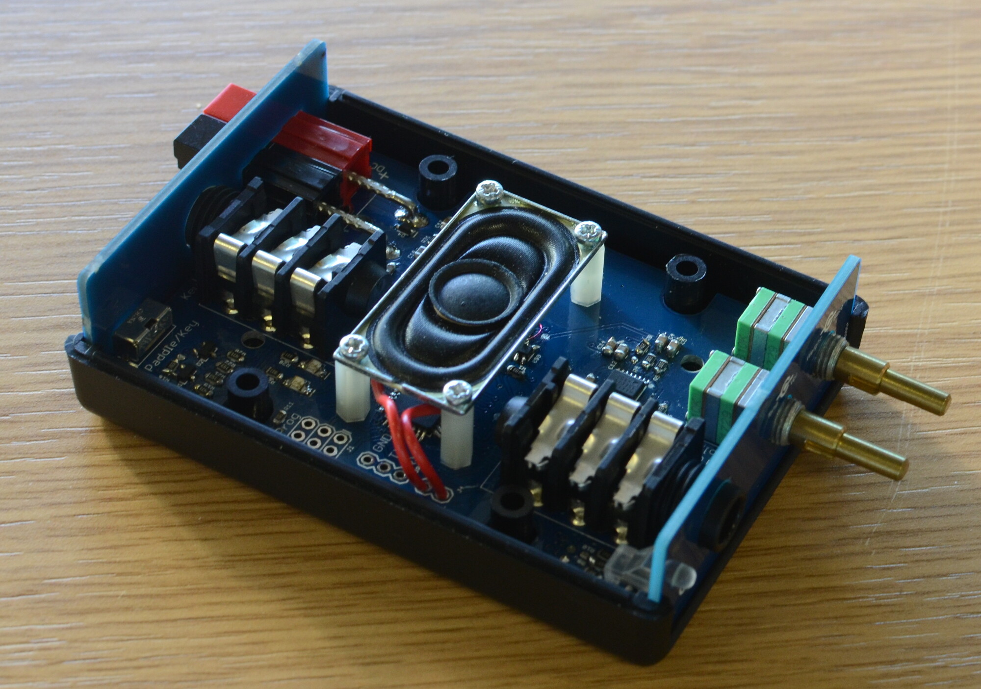

There was this thread about cases made from FR4.
This link from the thread might be quite useful to the OP.
https://www.scorpia.co.uk/2018/09/23/making-pcb-end-pannels-for-enclosures/
