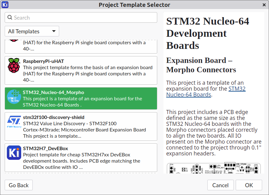

I have lost interest to take this further. It’s not very complicated but just a lot of tedious work and I have no personal interest in it. It is also a very bad choice for a beginners project. It is a quite involved 6-layer PCB and it’s too easy to get lost. It’s also completely unnecessary. To make a PCB that can mate with this nucleo-144 you just need the PCB outline and connector layout, and can simply delete the rest of the PCB.
