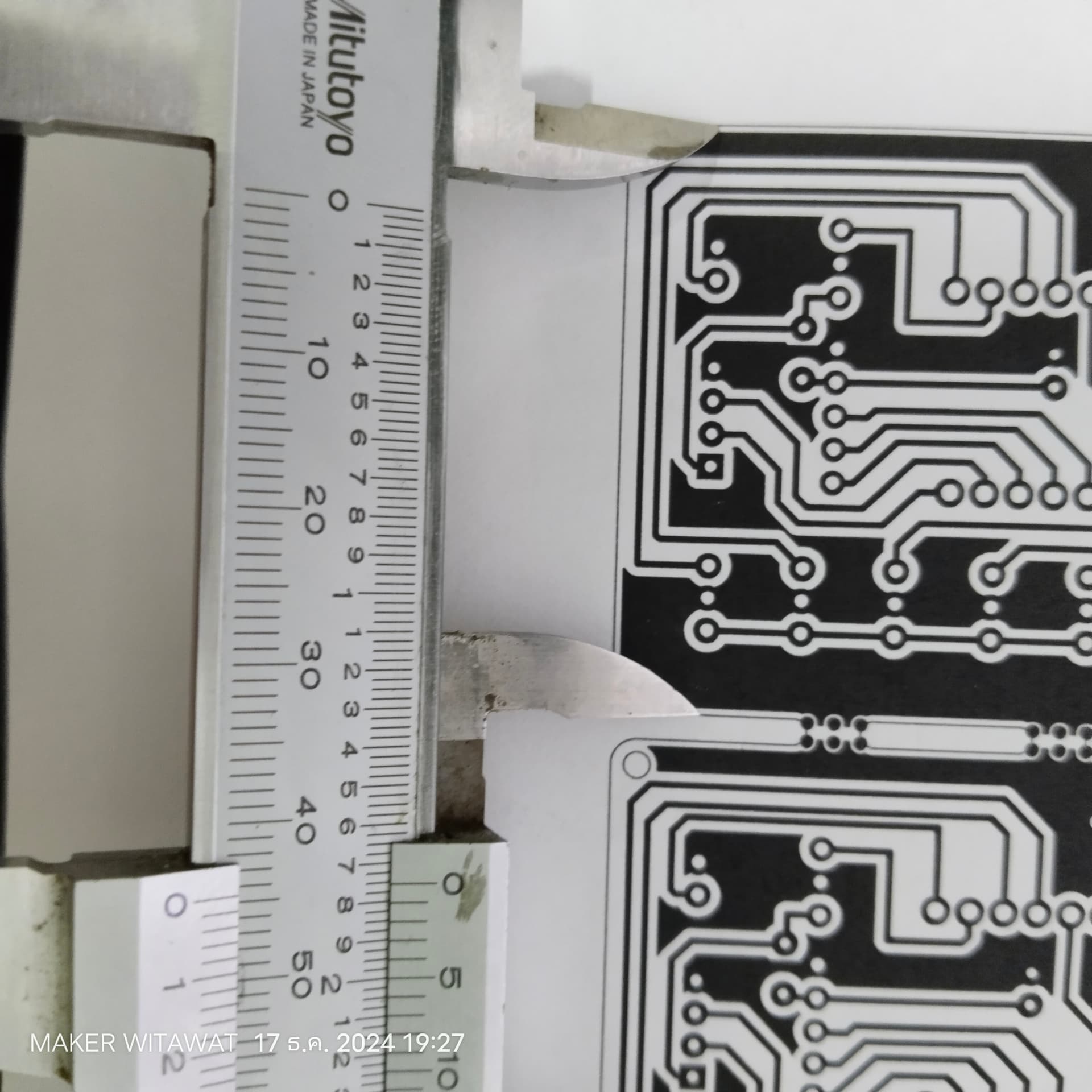

I have made a small pcb project by myself
but I have a problem with printing pdf by setting
it to the real size but my printer
can’t display it properly
Is there a solution?

If it is 45mm on your PC, and the printout is 45.3mm, then it prints too big, and you need a scale factor that is just a tad smaller then 100%.
45/45.3 = 0.9933774 = 99.3%
You can do more accurate measurements of the paper when you print out something bigger. Something like a 180 by 270mm rectangle for example.

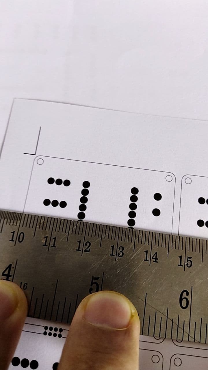

I tried with Kicad and still have problem
When I use A5 paper to print, the result is some part of paper will not be as designed
I am not sure if it is A5 paper or not
But when I try A4 paper, there is a problem near the edge of the paper. It seems that the printer is trying to adjust
the size to fit the paper itself.

Adding a specific scaling factor to the output to your printer driver does not work as intended if your printer driver applies it’s own scaling factor (such as “scale to fit”).
Gosh, I hope OP reads and understands what I posted… and that it should be obvious to him/her that Scale to Fit is Not 100%… never know what folks think and do…

this size 44.5mm not 45mm
this 44.5 + 44.5 + 2 = 91 mm
can scale in kicad one size ?
50mm x 44.5mm

Your output is 1.1% smaller than actual, so if you enter 1.011 in the ‘Custom’ field and you should be good.

This may Help… In your video, I see you’re Printing according to Objects Tab of appearance manager…
I print the Drawing Sheet….
ADDED: Follow-up I printed using Both and you can see the slight-dimensional difference on the Width’s…
can’t print on A5
i try move pcb can print on A5
i set scale 1.011 this size not fix one size
A4 Print Drawing Sheet OK
Size 50 x 45mm
A4 Print according to Objects not ok
