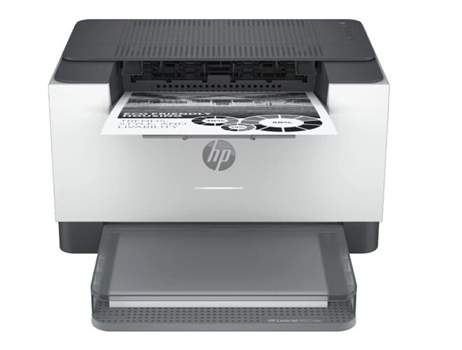

Help can't scales pcb size in pdf to real size on print by laser printer?
Have tutorial for plot ?

no now i contact hp print for check my printer
i wait service on site
agent support test on my model hp 107w
him say can print normal
Laser printers are not accurate devices.
Once you realize that, your life will be much less frustrating. Just figure out the required scale factors to correct the error, and re-size the print with an external editor.

HP said replace with new LaserJet M211dw

Now I have received the HP M211DW printer.
Print quality is accurate, good.
There may be a slight problem with the long paper core, there may be a deviation of the edge or something at 0.4 mm.
In testing with A5 and A4 paper
If the size is not correct, you can adjust the size with the inkscarp program by reducing the size to 0.1 mm and the work will be exactly the same.
