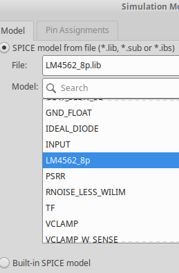

My previous post explained how to expand the LM4562 model from 5pin to 8pin as it ought to be. However it was based on the tutorial which requires two files. Nothing wrong with but I believe the task can done with just one file. It requires a simple change to the official LM4632 model file.
First find the AMP subckt and delete any subckts above. Next insert the following:
.subckt LM4562_8p 1out 1in- 1in+ vcc- 2in+ 2in- 2out vcc+
   XU1A
   + vcc+          ; VDD in LM4562_5pin
   + vcc-          ; VSS
   + 1in+          ; VIP
   + 1in-          ; VIM
   + 1out          ; VO
   + AMP           ; side A instance
   XU1B  vcc+ vcc- 2in+ 2in-  2out   AMP  ; side B instance
.ends LM4562_8p
KiCad automatically assigns the correct symbol-to-model pins as shown int the Simulation Editor snapshot.
--------------- Simulation Editor snapshots -----------------
Reference    U1
Value        LM4562
Datasheet    http://www.ti.com/lit/ds/symlink/lm4562.pdf
Description  Dual Audio Opamp, DIP-8/SOIC-8/TO-99-8
Sim.Library  LM4562_8p.lib
Sim.Name     LM4562_8p
Sim.Device   SUBCKT
Sim.Pins     1=1out 2=1in- 3=1in+ 4=vcc- 5=2in+ 6=2in-
             7=2out 8=vcc+
