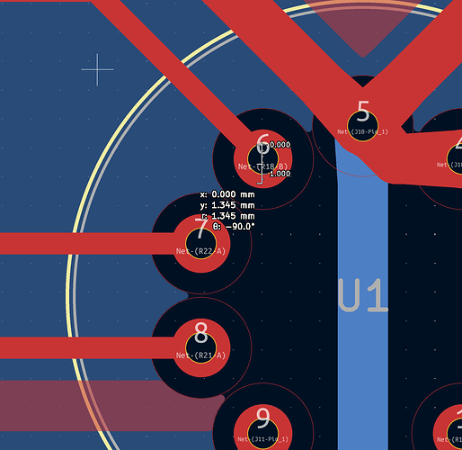

I’m about to go to fabrication with this PCB, but one thing concerns me:
The size of the vias for the tube socket pins is quite small. The footprint is for a tube socket, but what PCB mount tube socket has pins as small in diameter as a resistor lead?
From what I can measure, it’s 1.35mm diameter hole size. I’m wondering if the individual who made this footprint had access to PCB mount tube sockets for actual measurements.
They are not called vias, they are just plated through holes. Vias are normally filled.
Trust no-one when it comes to footprints. You should have the socket to hand. If the holes are not large enough go ahead and alter the footprint pads.
Those lightbulbs have been obsolete for many years, I find it amazing tat they’re even in KiCad.
I don’t know if the original was designed for direct mounting or for a socket, but it’s easy to modify it yourself. Just hover over the footprint, press [Ctrl + e]* to load it in the footprint editor and make your pads and holes bigger. When finished, just close the Footprint Editor, and KiCad will prompt you to save the changes back into your project.
And yes, it’s good to verify such things.

I was able to edit one footprint, but noticed it didn’t carry over to the other two footprints. Is there a way to make this change to the library footprint itself?
One thing is that now the “courtyards” around each pin are overlapping. Does that pose a problem for the fabricator?
When you edit a footprint you have the options of editing the copy in the layout or the one in the library. You should have either edited the library footprint and then updated the layout footprints or pushed the layout copy back to the library and then updated the other footprints from there.
I get an error that library.pretty is read-only when I try to save back to the library.
I’ve made my larger holes but DRC is not happy now:
Is there a way to expand the circle of holes in a controlled, symmetrical way?
That’s expected, the standard libraries are read-only as they will be updated when KiCad is updated so you should not store personal versions there. You’ll have to set up personal footprint libraries. Read this FAQ:

Trying to modify existing footprint, but I cannot find a command to expand the diameter of the array of pins. How would I do this, short of manually moving and guessing where each pin goes?
I wish I could see better! Reading is a luxury my eyes no longer afford me. :frowning:
There is no way in KiCad to expand the radius of a circular array of pads in KiCad directly.
But it’s quite easy to create a new footprint. But the first thing you have to master is how to handle libraries.
Once you have a writable library, you can use: Footprint Editor / File / Create Footprint / Circular Pad Array. This is a footprint generator wizard designed for circular pad arrays. If you create a pad array with 10 pads, they will be at 36 degree angles. After the array is created simply delete one pad.

The pads are rotated 180° from where they should be.
Okay, exported to Footprint Editor… but now, how to rotate so it’s oriented like the tube socket footprint from earlier?
Ah, I made the radius too small. Start over?
Made new footprint from scratch. But orientation isn’t right. The gap should be at bottom. How do I rotate this so it’s oriented correctly?
I found the rotate tool, but it’s in 90° increments only… The orientation is still not right. The gap (pin 10) should be at bottom.

Yes, just start over. That is the easiest, and 10 seconds of work.
And then, with the “Angle” you can modify the start angle.
Another simple method is: Footprint Editor / Edit / Renumber Pads Then (re) start with pad 1 and click on them in the order you prefer.
But if you wish, you can also rotate the footprint you already created, but you need another function. First select everything (or better maybe, only the pads), and then a right click and from the context menu, select: Position Tools / Move Exactly. Then don’t touch the X and Y coordinates, but only enter an angle. I used 23 degrees in the screenshot below.

I did update the socket footprints and it creates some very difficult to rectify DRC violations. Dozens of them.
I thought I’d try using the original footprints, and finding sockets that match those diameter dimensions. I should be able to solder these directly to the PCB and then just plug in the tubes.
