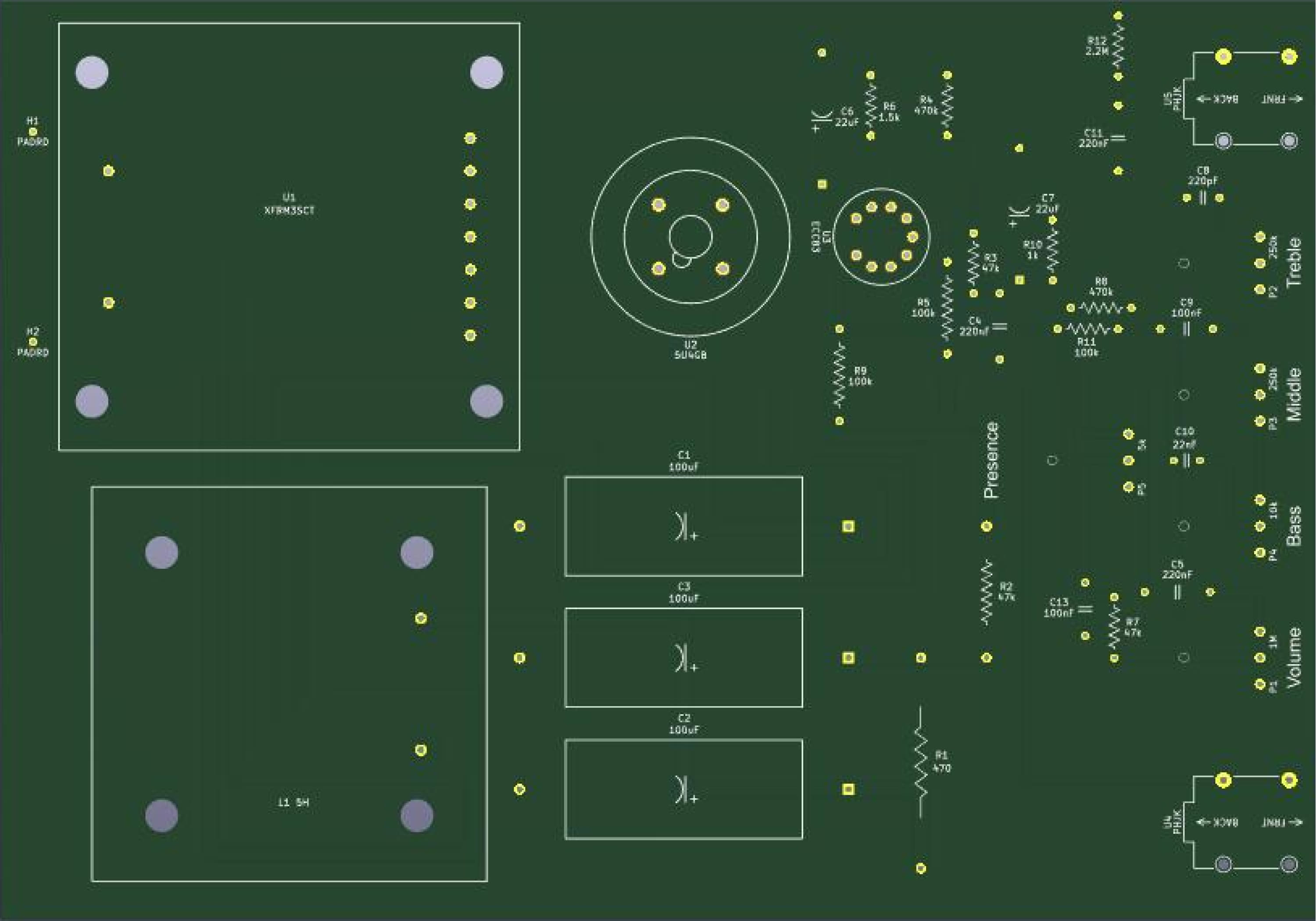

PCB layout halfway completed for reference:

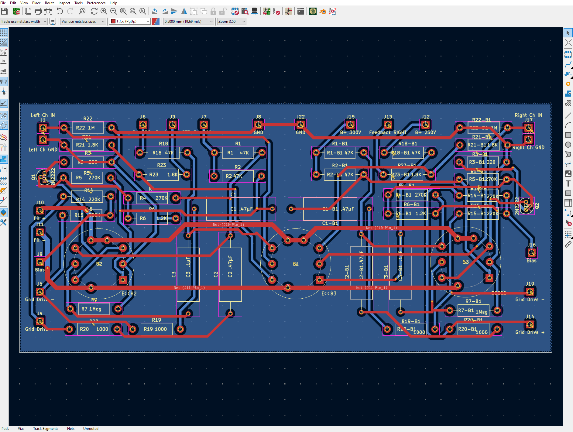

Maybe because I got confused and did step 4 twice, once for the blue to red layer and once again for the red to blue?
At any rate, I’ve ended up spending several hours just manually placing parts, but the routing is completely different from the left half, even though I painstakingly mirrored everything…

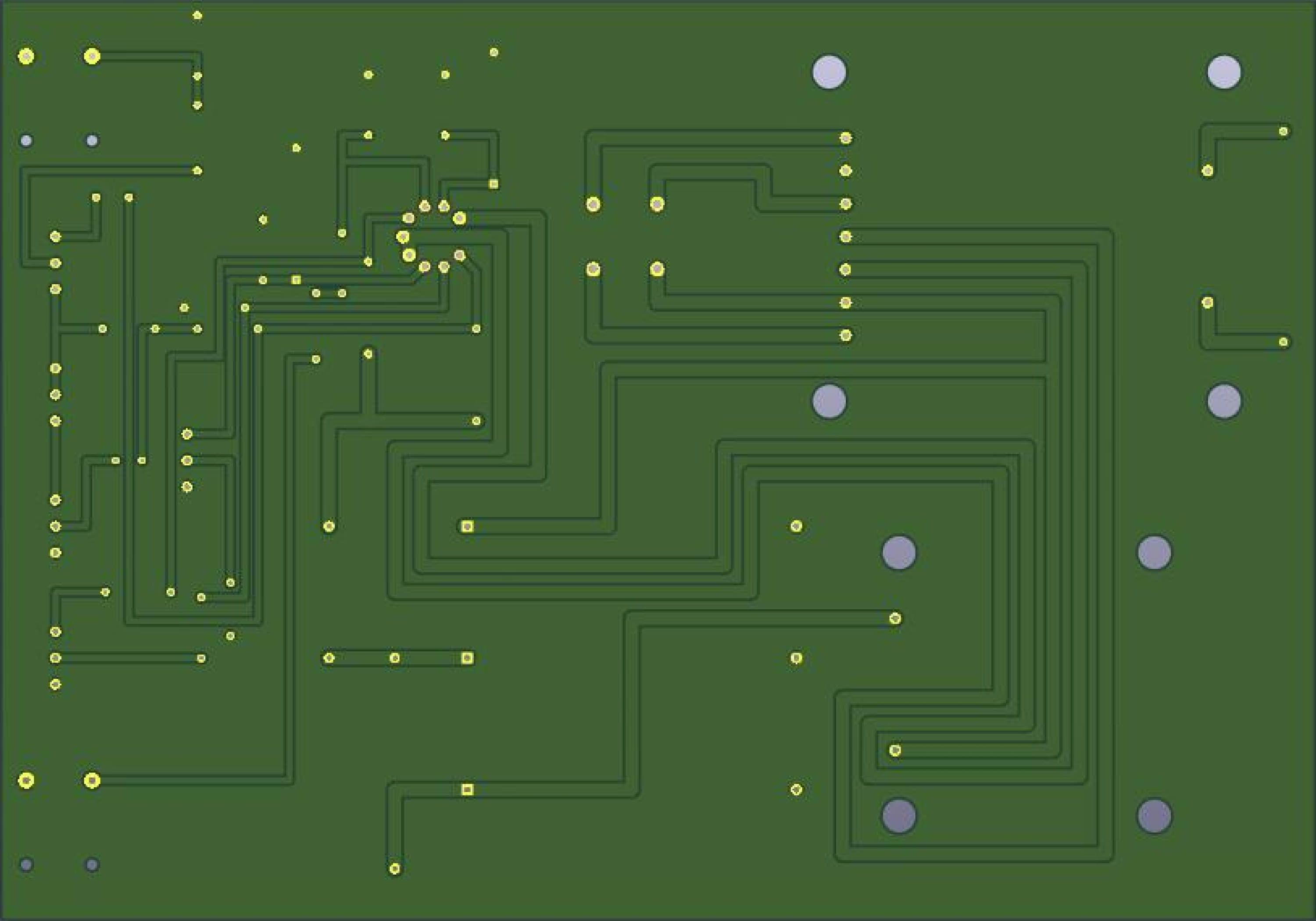

I’ve got nets that refuse to let me connect them, too:
This is what the board currently looks like. Almost there, except for several unconnected nets:

  2. It appears you utilized auto-route to begin with,
    based upon the ‘cosmetic symmetry’ pcb component layout.
    Near proximity of Filament, Cathode, Grid, Plate traces
    will cause extreme low signal/noise ratio.

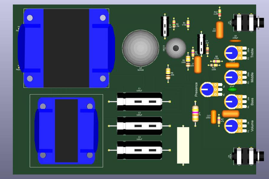

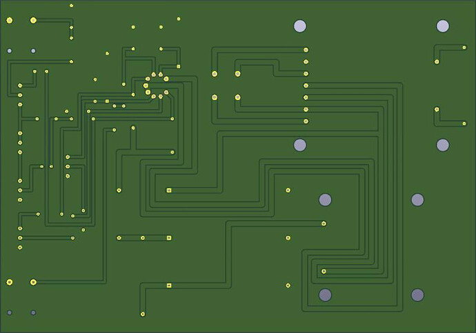

HERE IS AN EXAMPLE OF MY SIMILAR TUBE/VALVE PREAMP PROJECT
WITH ALL BOTTOM COPPER TRACKS LAYOUT
PCB TOP
PCB BOTTOM

I originally set the design rule for a 1.0mm trace and found that auto route would get stuck. A handful of traces done and endless loop of iterations after that. I had to go with .75mm to get it to even route the PCB. I’ll specify 2 oz copper at manufacture time to help. The traces that need to be large are the filament lines, as they carry 600mA in this configuration.
Spacing away from filament lines is a concern. Most of the lines cross at 90° angles, so crosstalk would be minimal. I plan to take a closer look at the PCB traces to see if any sensitive lines are too close to something that could cause positive feedback or noise.
I’m doing various iterations of the circuit to see what works best. I may try to increase specific traces widths and then re fill the groundplane. Sometimes I get a violation when increasing the width of a trace, so it’s a case by case basis.
