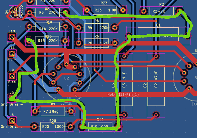

The current issues, and clearance violations. I would like to know if there’s a way to segment a trace so I can move a section of it to gain more clearance. When I try to move now, I’m stuck on both sides. Adding extra points on the track so I can move a section of it, not the whole thing, would be helpful.

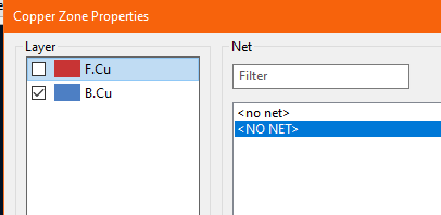

Curiously, there are no nets when I pour the copper fill and try to select what it should connect to. I’m not sure why that is. Didn’t run into this issue on the first PCB which I made totally in KiCad. The imported LTspice schematic for this PCB left me with numerous issues like this.

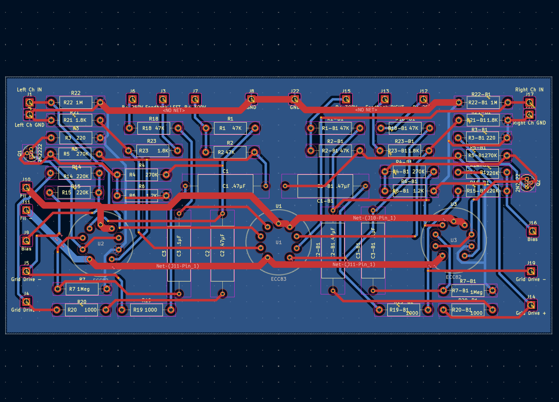

I had not looked at your routing earlier, but it looks like the usual wiring mess that is caused by a combination of bad footprint placement and an autorouter. It reminds me of a quote I read recently:
Good footprint placement is about 80% of a good PCB design, and that is before even the fist track is drawn. With good footprint placement, a simple analog PCB like this can usually be done on a single layer, so you can completely reserve the other copper layer for a solid and uninterrupted GND plane.
Yes, you can: select a track, then right click on it and select Break Track from the context menu. But it is a function I never use. An easier way is to just start drawing a new track, and when that track connects to a different section of itself, KiCad automatically removes the old redundant section. (This depends on PCB Editor / Route / Interactive Router Settings / General Options / Remove redundant tracks.

In the properties of the copper zone, you select a net name for the zone, and KiCad automatically creates connection of all the pads of that net which are inside the zone. In your screenshot you can see a few of these connections (created with thermal reliefs) in the upper right corner:
Note: You can remove all copper tracks for these nets (It looks like the GND net, which is good) Direct connection to a copper zone is good, zones have a much lower impedance then tracks, so the tracks are redundant. when you just rely on the zone connection, and remove the tracks for that net, you free up a lot of routing possibilities for the other nets. However, In your project, you’ve cut up the zone into a lot of barely connected sections, which greatly reduces the effectiveness of the zone.

The combination of bad footprint placement and autorouter spagetti just creates such a mess that you can’t easily recognize what else is going on. (Such as missing the GND connection to the zone).

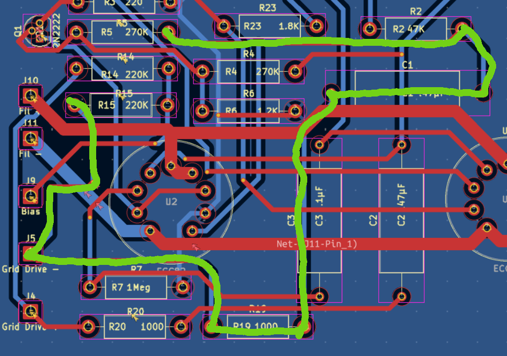

Have a look at the section I highlighted below. It is a part of three nets, with the connection through C1 and R19. That single track goes all over the place, and it greatly reduces the options for laying other tracks. It is a classical example of the behavior of a simplistic autorouter, and exaggerated by bad footprint placement. (Or the other way around, bad footprint placement makes a simplistic autorouter behave even worse).
To make something decent of this PCB, you pretty much have to delete all tracks, then make a decent footprint placement (Hint: making nice looking rows of resistors is usually a bad strategy for achieving optimal routing). And once the footprint placement is done properly (this is the difficult part) then routing is easy. When you do the routing with an autorouter, you skip the iterative process that lets you improve the routing. Quite often, routing can be simplified by just moving a few footprints. And an autorouter does not do such things. It just creates spaghetti really fast.

As for that trace, outlined in green, now that I consider the path through the capacitor, yes, it is a cicuitous route. This is one iteration of many experiments, as I dip my toes into this new “art”.
Thanks on the ‘break trace’ command. It’s name led me to believe it would actually break the connection, not add points by which to reshape straight runs.
As you can see, my grounds don’t have any nets:
I suspect that was a problem I created by importing my LTspice design. I should have re drawn everything from scratch in KiCad, like I did with the relay PCB and everything would have the proper nets.
I was thinking of trying different methods for layout. This layout came from a plugin “Schematic position” which arranged the footprints in the general flow of the schematic (supposedly). They were an overlapping mess and I needed to move every footprint to make space between them.
My B+ lines still are separate (they should be common), so I’m guessing there are missing nets and the PCB editor doesn’t know how to assign them.

1, find out why there’s no nets on most of the parts, especially grounds.

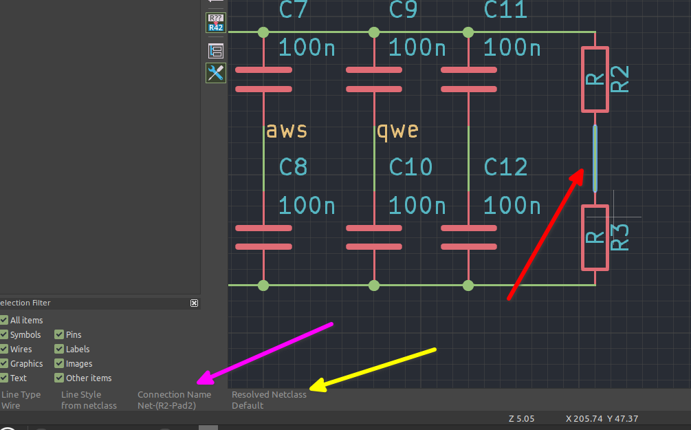

Netclasses is the concept you want to look into.
If you draw (not copy from somewhere else) your schematic, each wire, when highlighted, will show its “net” in the bottom left of your screen.
See below:
The wire between R2 & R3 is highlighted (red arrow) and the Connection Name shows the “Net” (magenta arrow). If a Net exists here, when you go to “Tools” then “Annotate Schematic” then “Update PCB from Schematic” your PCB will show all the footprints and ratsnest lines.
If Nets are missing on your Schematic, you haven’t used “Schematic library symbols” or “wires”. Note; graphic Lines and Busses are NOT wires.

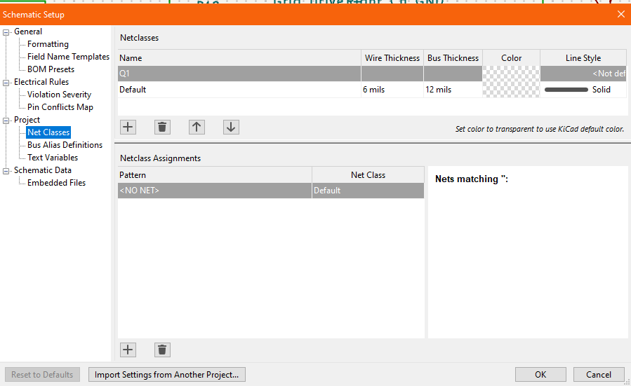

As @retiredfeline mentions, Use Net Classes. Find this at “Schematic Set-up > Project > Net Classes”.
If you set these up correctly, the Net class will show, when a wire is highlighted, at the bottom left of your screen next to the Net. See yellow arrow in above screen grab.

It looks like things went astray because I imported my design from LTspice.
As opposed to the relay board I made this past week being started from scratch in KiCad, which didn’t have these issues of missing nets.
I’m seriously considering redrawing the whole schematic in KiCad, so that all my wires will have nets and the PCB layout will have the correct connections. At the moment, I have nothing:

You can assign a netclass to a track, but better is to assign a netclass to a net or group of net by the net name(s).

The Track box allows you to either use netclass widths, which you create in Net Classes, OR, use pre-defined track widths which you create in Board Setup > Design rules > Pre-defined sizes (May also be accessed through the “Edit…” link at the bottom of the list in the “Track” box.
Hotkeys W & Shift + W will scroll up and down the list of track widths you assign to Pre-defined sizes.
It is best to read up on Net classes here in the Kicad Docs. if you want to venture there, before you ask questions.

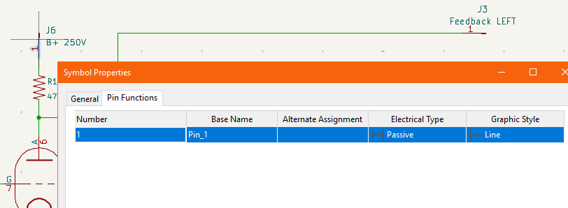

No, that is definitely not the case. I have not done an import from a ltSpice project myself, but once a schematic is imported, it becomes a native KiCad schematic and everything should work as normal. There is no need to redraw the schematic. However: In your screenshot below, there are no nets listed at all, and that is very wrong. You could not have drawn the PCB as you did without a proper netlist in the PCB editor. You also would not see ratsnest lines without a netlist.
I am guessing you have the [ ] Hide automatically generated net names checkbox on, but even in that case you should see the nets for the GND and power symbols. It is possible that KiCad does not recognize the imported power symbols from ltSpice, and you have to replace those with native KiCad symbols. You can do this with the Change Symbol button inside the properties window of a symbol, or do it with: Schematic Editor / Tools / Edit Symbol Library Links.
