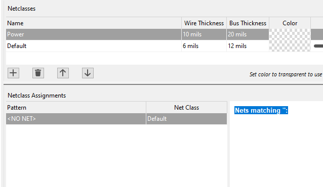

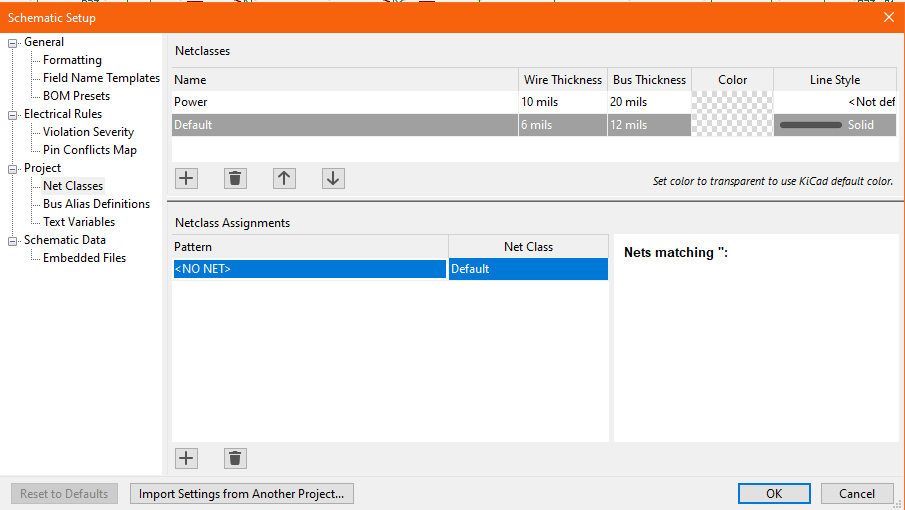

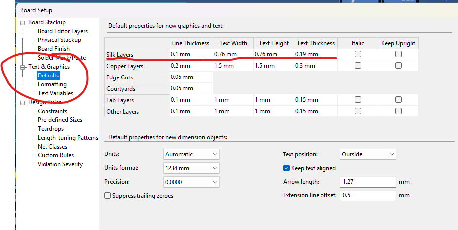

I think that article assumes the schematic HAS net classes. My imported from LTspice apparently lacks them, so I still need to find out how to create them. It seems I cannot do so from this menu:

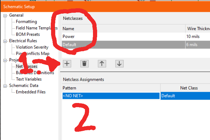

Euhm, yes, that is the right place to create a new net class. In your screenshot, there are already two netclasses: Default and Power. To create a third netclass, just click on the plus indicated at 1.
There is also an important distinction between a Netclass (which is a set of rules for track width, clearance and such) and a Net which is a bunch of wires that connects pins (in the schematic) or pads (on the PCB) to each other.
After you’ve created the net classes, you have to add nets to the net classes. The netclass assignments are done in the section of the menu indicated by 2.

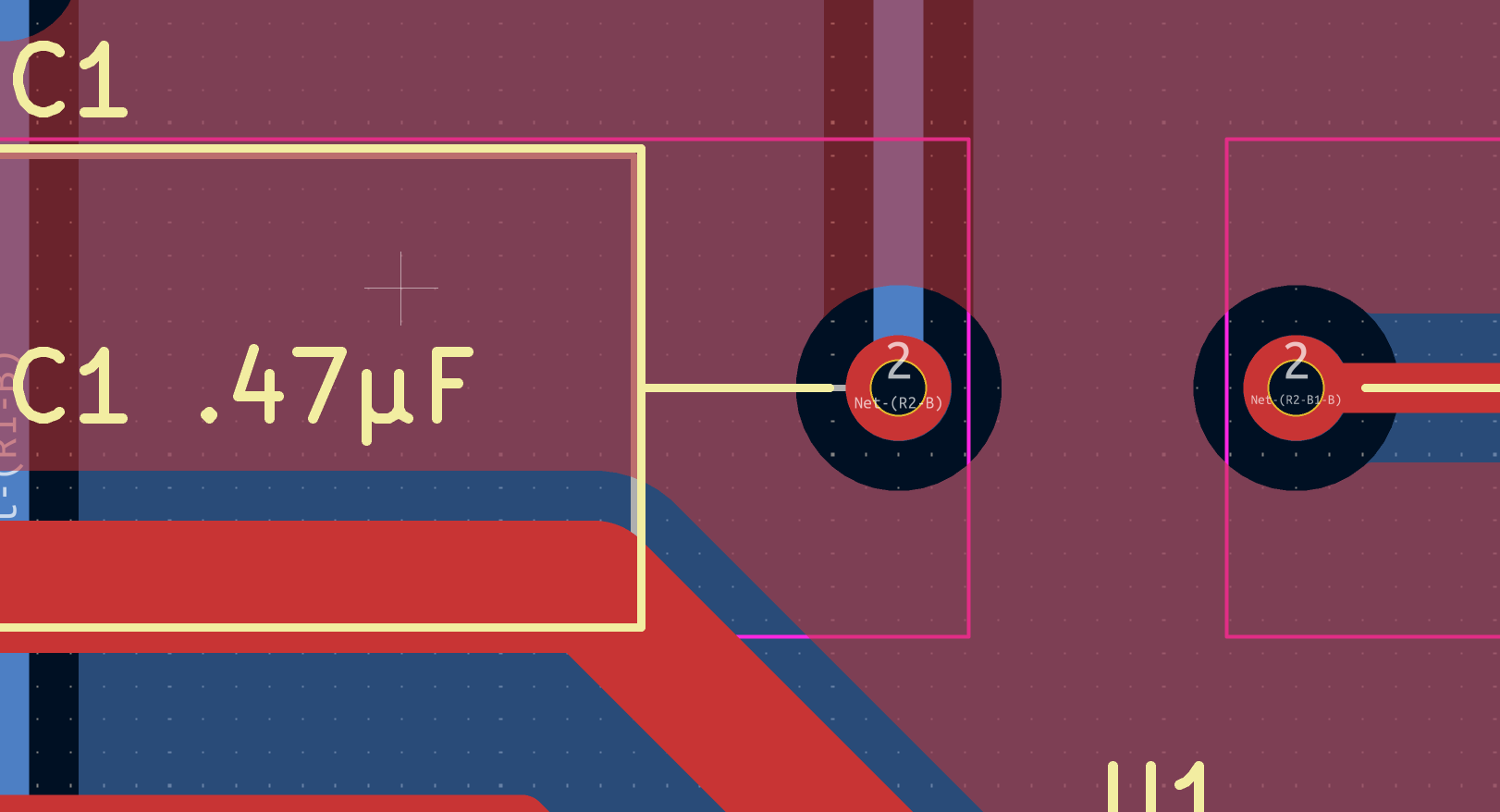

Many of my traces have on them when I zoom in. This problem is only with my imported from LTspice file. The other project, which started from scratch in KiCad, has no issues like that. I looked all over for that hide automatically generated net names check box. Searched the forums, but it’s not where the folks are saying it is. Preferences… Display Options… I can find several Display Options under each of the editors, but no such check box. Maybe it’s there and my blind eyes have missed it?

That much I was able to make happen, but what’s bugging me is the blue highlighted area on the right:
In the manual, there are nets in that field. In my LTspice imported project, there’s nothing.
While it would take less time for me to completely remake the project in KiCad, I am trying to use this as a learning opportunity to see if I can fix the project so that these net classes appear. I should be seeing Vcc and ground at the very least. Any idea why it’s blank?

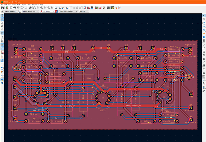

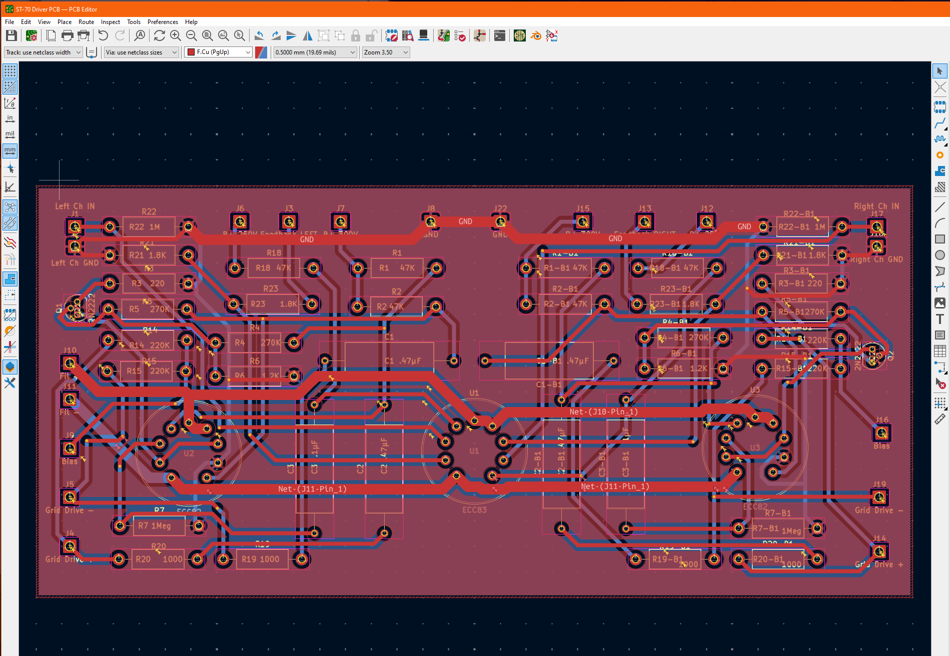

After being distracted by a botched Windows update which rendered my graphics workstation unusable, I’m revisiting my driver PCB project.
One of the oddities I haven’t found the cause of is that my ground nets are shown as a trace, but also tied to the copper ground plane fill. Wouldn’t those ground traces just become part of the fill? Why are they displayed as traces? What setup mistake have I made to cause this?
It’s working normally. Tracks have a separate existence to fills.
Note in the Appearance pane, you have control of the opacity of different objects. The default for KiCad has the opacity of Zones set differently than the opacity of Tracks so they ‘stand out’ a bit. If you want them to ‘blend in’, set the opacity the same for both.
You have the choice of various connected objects in KiCad, in rough order of “stays exactly where you put them”:
  • Graphics: circles, arcs, rectangles, polygons text etc. Doesn’t automatically avoid anything. Basically fully manual.
  • Tracks: placed by the interactive router tool. Will actively avoid graphics and tracks of different nets in walkaround mode. Will push other tracks away in push-and-shove move, but not graphics. Does not avoid zones.
  • Zones (aka fill, pour): fill the area automatically but stay away from tracks, graphics and keepout areas with specified clearance.
Any of these can overlap. If you draw a track through a zone of the same net, the function is that if something on a different net or a keepout “repels” the fill, the track will remain in place.

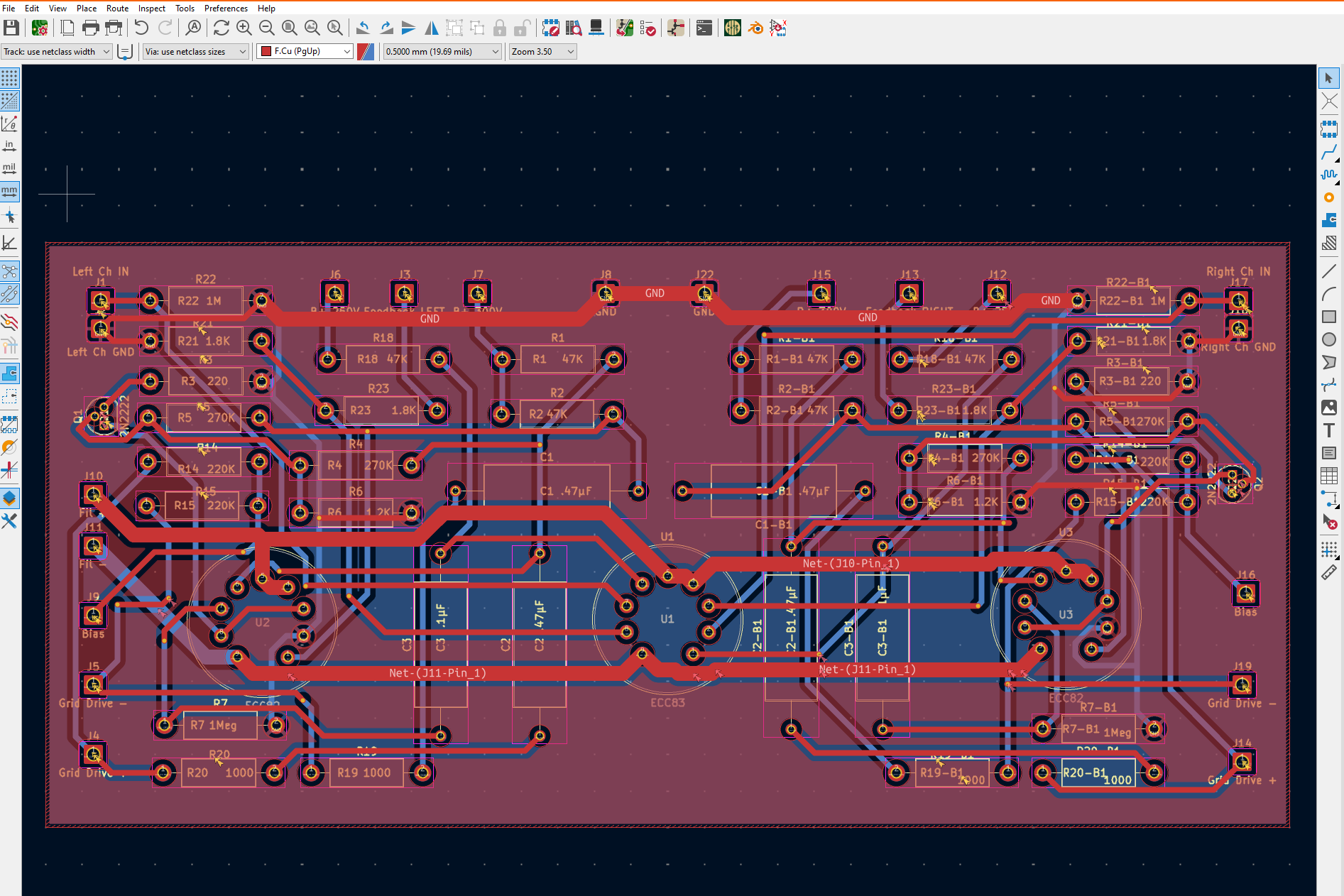

Yes, I see if I make the copper pour zone opaque, then I don’t see the ground traces anymore. They are all one copper fill.

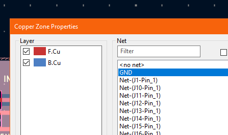

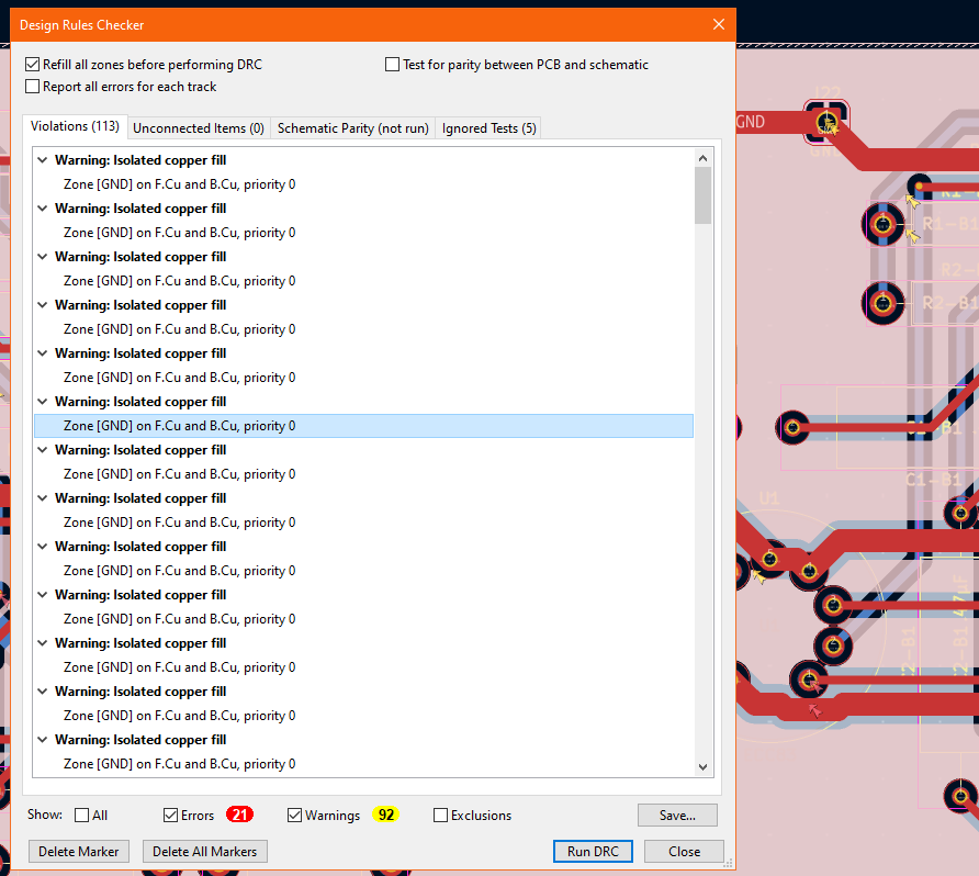

But the DRC is still complaining, even if the copper fill is set to GND net:
There are over a dozen of these and they all point to the copper fill being isolated from GND. What am I missing here?
It’s issuing a warning that you have isolated ‘islands’ of Cu fill. If they’re an ‘island’ that doesn’t connect to a pin or via, then they’re floating. Note how around your circular tube socket, there isn’t enough room for the fills to flow around and between the pins, so it’s making isolated (unconnected) zones.
You have the option to have Kicad remove them (Remove island option in Zone Properties), change clearances such that flow between pins is possible, drop stitching vias on islands to force connection, or ignore the warning. Note you have zero Unconnected items, hence this is a warning rather than a error.
I’d suggest you try dropping a via say right in the center of valve U1. This will ‘stitch’ the isolated Cu island on Top Cu to the presumably not isolated Cu pour on the Bottom Cu since they overlap there. Re-flood and rerun DRC and you should see the number of warnings dropped. Rinse and repeat and you should be able to clear up all the warnings as it looks like you’ve got plenty of room.
Given that you have a ground fill on that layer, why run the ground traces at all? All they’re doing is reducing the effectiveness of the thermal relief spokes on all those ground pads.
I tried that and it did clear the errors. What threw me off was that the entire ground plane was highlighted when I clicked on each error in the DRC list making me think it was complaining about the entire ground copper fill, multiple times.
It did remove some islands in locations that were limited by clearances.
Now what remains is a ton of clearance violations that I have to work on fixing.

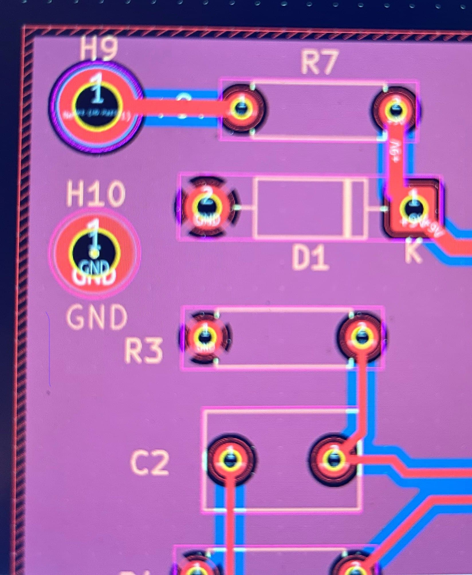

Saw this on a Facebook KiCad group:
This is how I expected my ground plane would work. Notice the diode connects to ground and there’s only copper fill and no separate trace.
What’s different with how that’s done vs how I did it?
You added tracks manually, they didn’t. Tracks are not trimmed away by filled areas. If you just want the thermal relief connection (the “X” shape), delete the track.
Tracks don’t have to end at a pad, so you can still use tracks to connect filled areas.
I was able to delete the traces that AutoRoute put there in the GND net, and re ran DRC. Deletion of those traces seemed to cause no new errors.

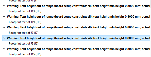

I still have a bunch of clearance violations to resolve and a large number of these:
Since this was an imported schematic from LTspice, it came with a lot of these kinds of issues. If there is a way to properly import LTspice schematic to avoid this, that would be useful information.
