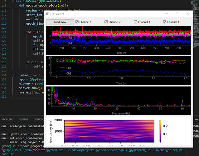

Hey Hermit: I was skeptical about AI for coding until I got started. Copilot in vscode improves auto-complete from the basic level, but it also has project-wide scope, so I can request things like “change docstrings from sphynx to google format in all files” and it highlights proposed changes in red/green for individual approval or rejection. Or add widgets to the gui layout, or add this method to compute… Yes, it needs to be carefully monitored, but I am coding much faster.
Here is an example you can copy/paste right now into chatgpt (free not even logged-in version) and get working code in a couple of minutes:
pyqtgraph/pyside6 program to open 4 channel 500sps 24bit wav file,
plot raw data with an adjustable epoch region,
plot time-domain epoch, plot fft of epoch,
and plot each channel in different colors.
Also plot scaleogram of channel-1 epoch using cmor4.0-4.0
and plasma colormap.
Add checkboxes to enable/disable channel plotting.
For epoch plots use mouse wheel to zoom y-axis, right-drag to zoom x-axis, and left-drag to pan x-axis.
Now paste the generated code into a .py file (and add the needed packages to the venv), run it and bada-bing, bada-boom you get:
Frickin’ cool imho. It needs lots of tweaking, but what a motivating way to get a project started.
