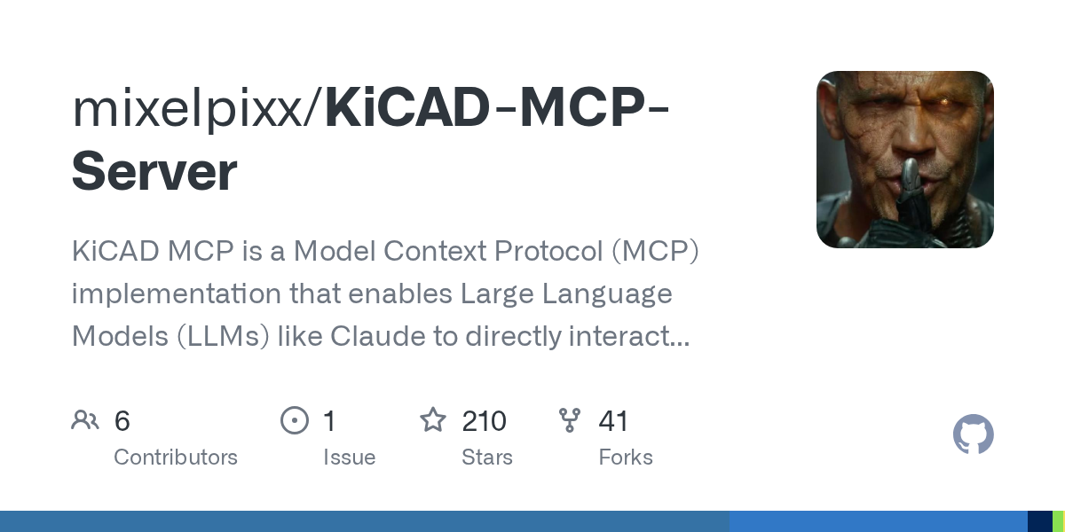

Not sure how many of you use ai or LLMs in your day to day. I use them for code a lot, and I wanted to use it for design as well. I have created an MCP (Model Context Protocol) Server that allows a user to pair Claude AI with KiCad. I am looking for feedback, here is my repo:
This will work with Claude desktop, or with VSCode and Cline, or any other MCP Client you wish to use.

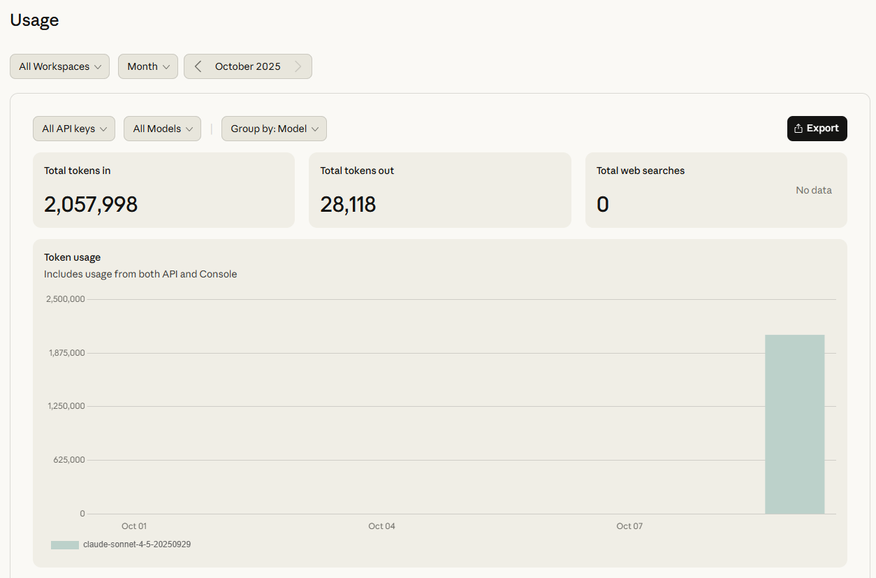

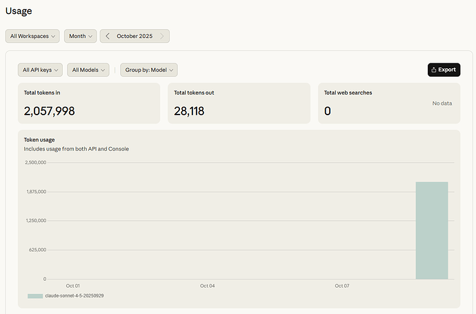

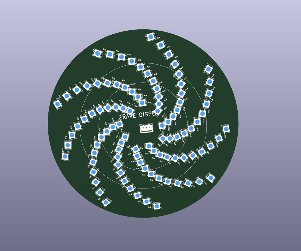

Just to report back. This MCP server does in fact work. After a short time (and a bunch of tokens burned) it created this LED board.
It’s not perfect, as some of the LEDs overlap, but I’m sure if I continued to prompt, I could get it to do more. Well done @mixelpixx! I hope this is a helpful tool in my kit moving forward. :slight_smile:
Would you care to share your experience using this MCP? It looks like there was only about an hour between installing it and completing the KiCad design, so it couldn’t have required extensive, detail-oriented prompting. How many and what type of prompts did you use?

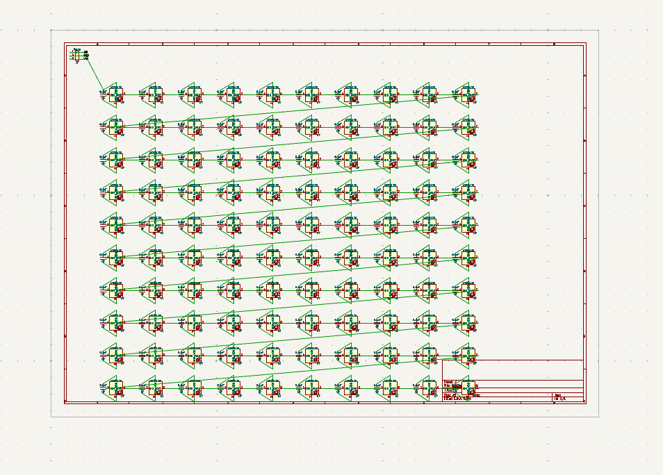

I’m not sure if the PCB portion of this works; I didn’t get to that. And it probably does, because KiCAD has a full API to handle PCB. What it doesn’t have is ANY schematic support and what I was wanting this more so for schematic creation and the ā€œdeveloperā€ said it was working. well, come to find out that’s literally impossible. Firstly you can’t even build this project in it’s current deliverable state, right out of the box. so I’m not sure why people came back to this thread and said it worked without noting that it’s thoroughly broken. This person doesn’t ā€œcodeā€. Otherwise this AI slop would have never been pushed to github.
Just to address the repo issues:
  • there is no .gitignore
  • dist folder was uploaded
  • pycache was uploaded
I’m surprised the node_modules folder wasn’t also uploaded.
The README file is clearly written by AI. That’s not a problem. What IS a problem is how confidently it states that this is ā€œproduction readyā€ and the schematic manipulation works.
Let’s start with the first issue with the code of this application. It is missing 4 files in the source folder that are imported elsewhere. You can’t even build this. Luckily, the dist folder (WHICH SHOULDN’T EVEN BE THERE) had the transpiled files and Claude reverse engineered those. I never really got as far as testing that stuff, because it built, which was what I initially just wanted to get past, right? But, if those files didn’t exist, this whole repo would have been useless. Why no one else noticed this and just came in here and sang its praises, is beyond me.
OK, so I get them built, I get it hooked up to Claude Desktop. It can’t do stuff. It starts loading schematics, but there are typing errors. Get that fixed, there are missing methods in kicad_skip as Claude tries to add a simple component. Come to find out, the functionality it requested aren’t even real freakin’ methods that kicad_skip provides. Basically, kicad_skip is taking an existing schematic and manipulating it. It can’t add components they have to already be present so it can clone components. I’m not sure what the use case is for that, but at least from the concept of trying to put things in some sort of automation, that just isn’t going to cut it. So, essentially, this schematic feature NEVER worked. How do we know the ā€œdeveloperā€ just used AI and had no clue what they were doing? They clearly just asked AI to build a feature, build tests around it that DO NOT work, and then have it update the README saying confidently that the feature worked just to manually upload a folder from their PC directly to github. That is not how a typical developer does their code.
I fully documented what was found here:
As a developer, I never expected non-working, non-tested AI Slop to make its way to github. Thoroughly disappointed with what I just experienced.
