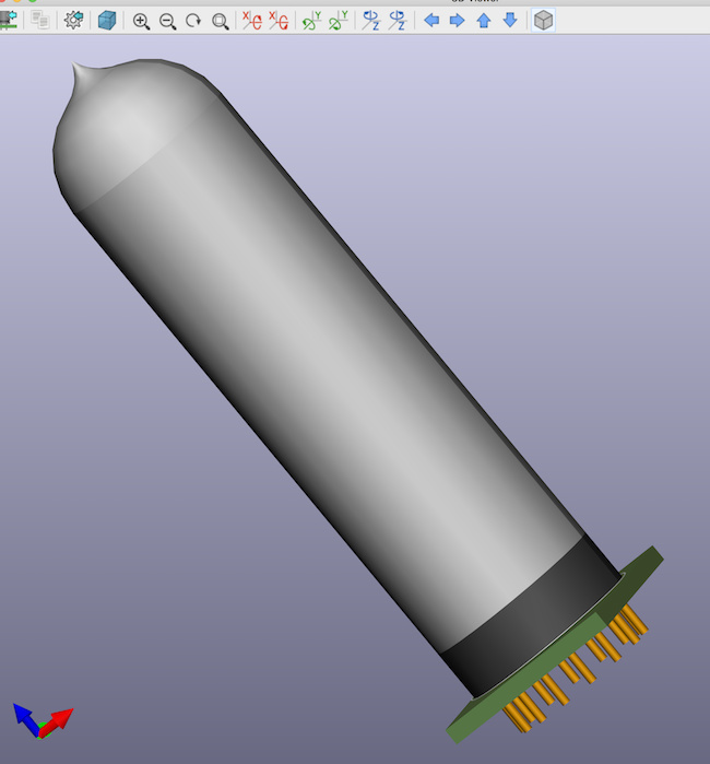

Just wanted to give you a brief feedback that your 3D model for ZM1022 with base/socket matches perfectly with the footprint used in the pcbnew. The combined 3D-View of the PCB looks nice. Though, here the tube is looks almost opaque irrespective of the viewing angle. One can’t see the plate electrodes inside the tube.
Best regards
Re: the Anode/Cathode - numbers would be done via ‘Piping’ to look real. I’m too lazy (piping 3D is time consuming). I looked at several of these tubes and see some show numbers in vertical some horiz. I simply did a view from the top (in space) and left the Plates as was.
Re: the Base - added the attach pattern. I did not make the contacts as shown in your photo (wire blades).
If using the Base you show, you’ll need a large diameter hole in PCB for it. If intending to rest it on PCB with the blades going through holes, you’ll need to dial the hole diam’s in such that they don’t touch. That may be a problem - you’ll figure that out…
Also, the dimensions in your photo indicate Tube’s glass will interfere with mount screws (without hardware in-hand, I can’t assess it and probably wouldn’t bother for my own project). Other things I didn’t bother to do: Raise the tube on a perimeter-ring for screw-head clearance, Radius’ing the mounts top edges…
Again, the graphic with transparency will not show in Kicad/Step/Wrl so, ‘Solid’ is what you get (along with photo of transparency).

I was bothered by the loss of the tube’s glass transparency and not getting what I wanted. I conjured up some approaches to try - just to satisfy myself. It took a bit of trial/error but, I finally got far enough that I’m satisfied.
Though this post has grown an over-whelming amount, I want to leave it with a Better part model. Posting the .WRL (Step file looses transparency so, not posting it).
• Changed the Flat 2D number to 3D
• Recolored for improved Graphic that yields a Glass look (by setting the Parts Appearance transparency and using StepUp’s material selections, not FreeCad’s material )
• Tweaked Base (still a concept based on useless dimensions)
Tube4D.wrl (828.5 KB)
Some views…
