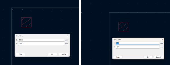

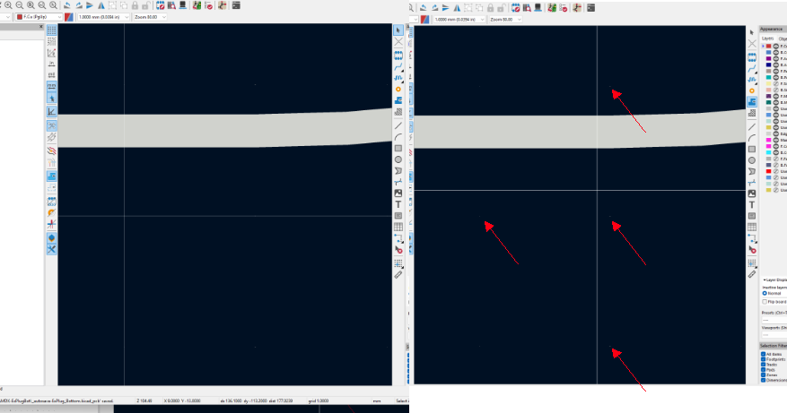

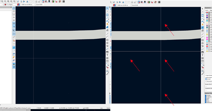

Filled zone grid offset
Layout grid set to 1mm. With nothing selected, cursor snaps.
When filled zone selected there is an offset… why?

Check this thread: 9-0-4-strange-part-move-grid-snap-behavior
It is a problem that has first shown in 9.0.4
Big thanks!
Confirming, that updating the grid origin EDIT>GRID ORIGIN (delete the change after the decimal) allows snapping to the grid.
