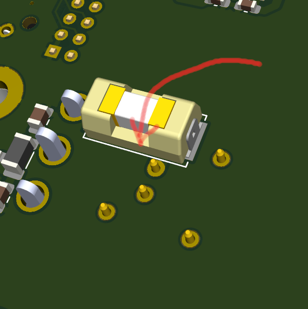

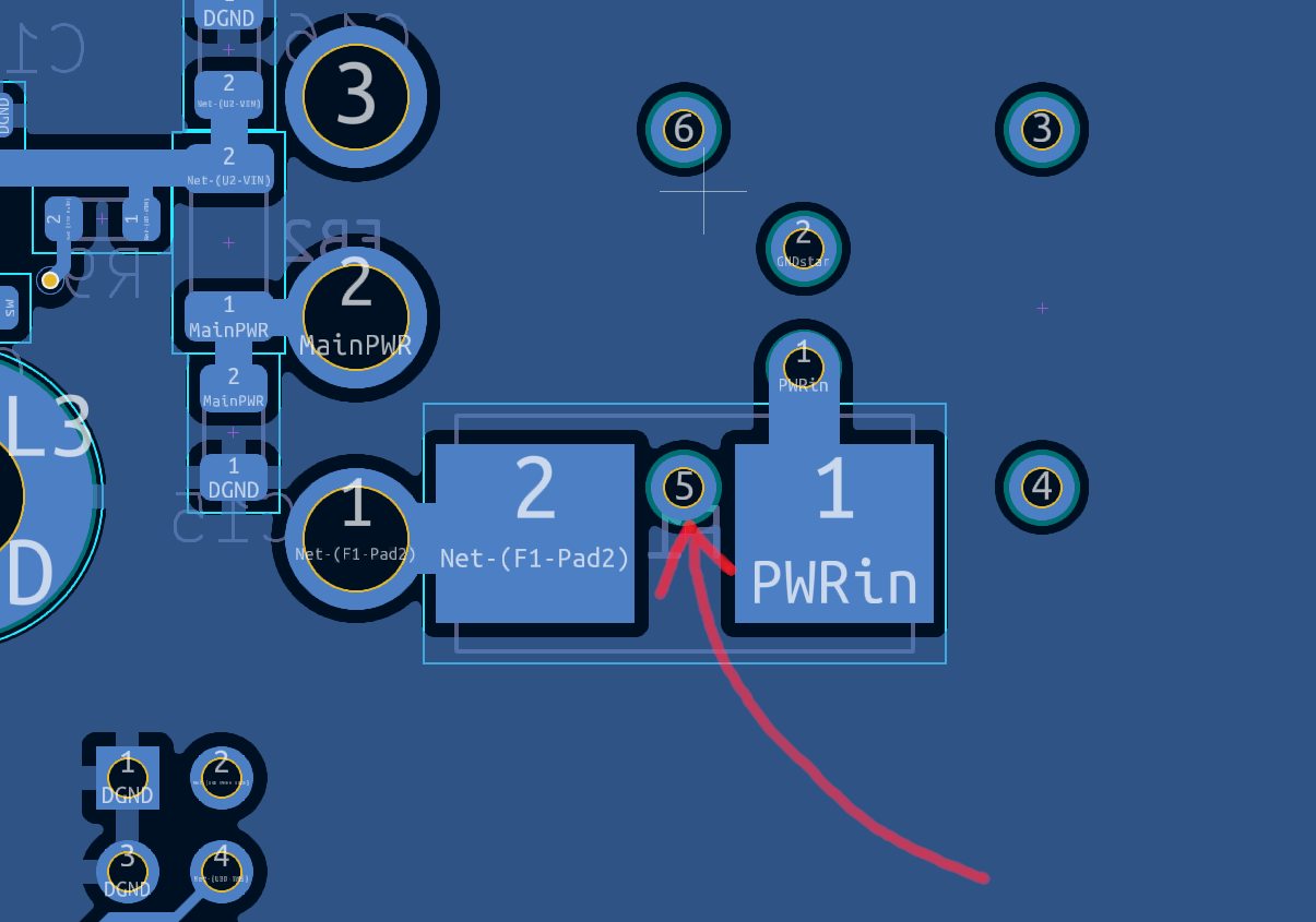

I place a THT-device (connector) on one side and a SMD device on the other. I miss interpreted the THT pin as a via and accepted it inside a SMD device:
While the DRC was fine, caused of cause a mechanical collision.

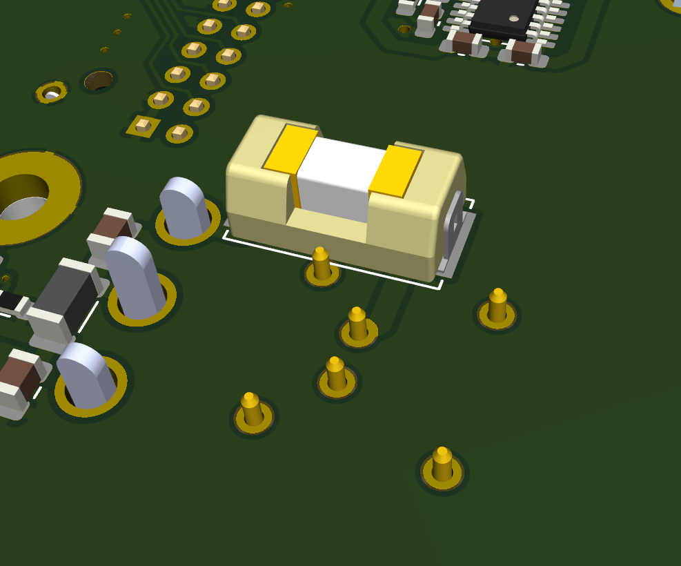

This is how it would look like if I had been aware if this:
I did not find a DRC-Option, which checks for THT pins from another part inside a SMD components courtyard.

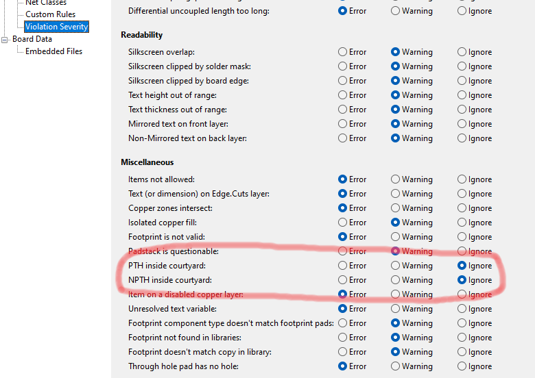

The only thing that can be checked is PTH and NPTH inside a courtyard, but this will go off on every via, which is OK and should not throw an error. Thatâs why I turned this one off:
What is need would be a âTHT via from other footprint inside courtyardâ.
Did I miss something or what is a good solution for getting this into my DRC?

OK, so the solution is to have the two option:
PTH inside coutyard
NPTH inside coutyard
set to Error.
I wonder why the default setting of this important check is set to âIgnoreâ.
Where can we report this issue to be fixed for the next Release?
