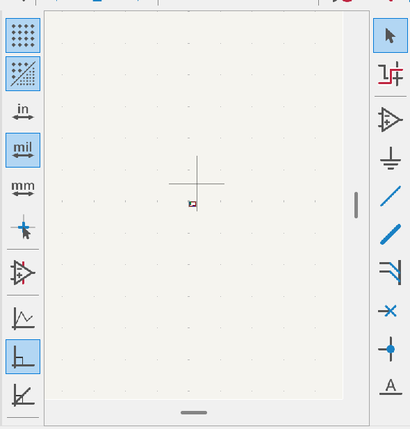

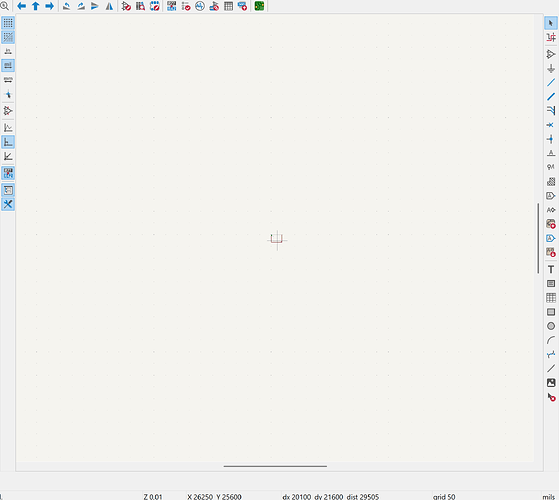

First, the whole usable drawing area (canvas) is way too large. Even zooming as far as possible doesn’t show the whole canvas. Zooming with the mouse wheel gives this situation:
Note how the scrollbar “thumbs” are still very narrow.
Zooming in with keyboard in this situation zooms out, so the wheel zoom and keyboard zoom behave differently.
I can grab the scrollbar thumbs, move them and see the (assumed) whole usable drawing canvas. But I wonder if anyone ever needs that.
In the previous situation, with that window size, if I zoom in as much as possible, the scrollbar thumb keeps it size all the time. Then, if I use the scroll arrow buttons, the thumbs don’t move at all and are useless in locating where I’m going, although the arrows themselves work (they always seem to scroll the amount of some percentage of the current view area).
With normal zoom levels the thumbs are useless because a tiny bit of thumb movement after grabbing moves the view way too much, for example using “Zoom to Fit” and moving a thumb moves the whole drawing page almost off the view, and when zoomed a bit closer, everything disappears from the view with the smallest thumb movement. I think this is what was described in the first post.
I don’t think the real problem is in the scrollbars, but in the way too large canvas which is useless for most use cases. I guess large enough width or height of the canvas would be something like 3 to 4 times the used drawing page width or height. Then the area outside the drawing page could be used for larger schematic or temporary or extra drawings or notes, as some of us use it. But I can’t imagine how larger canvas would be needed for any normal schematic. This is the maximum zoom distance in my screen with A0 page:

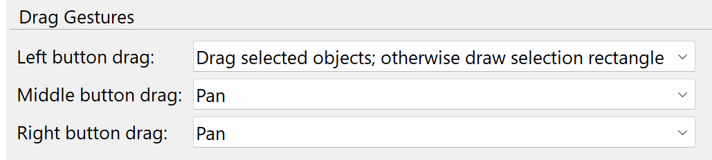

That’s not the only other way. Keyboard can be used. Shift + Arrow moves the viewport. Also, there are these settings:
Middle button drag was already mentioned, but the right button drag also works in case of missing wheel. It works well, is easy to use and is efficient.

So, you can assign Pan to right mouse button in Preferences, what’s the problem with that?
