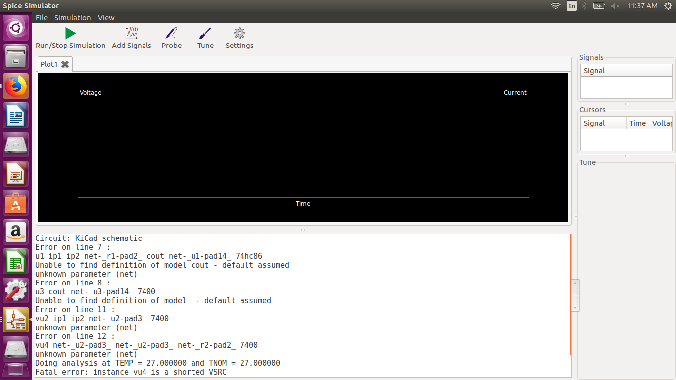

I tried simulating a half adder circuit but I am getting this error can you tell me how to fix this error

At first brush, I think you have problems with your schematic. You appear to be wanting to use 3 gates of 2 chips, yet you have 4 chips referenced (U1, U2, U3, and U4). Your XOR on U1 looks good (first gate is U1A and the power block as U1E, all makes sense). But your NAND is split across 3 references. U2 and U4 aren’t being powered. U3 is being powered, but none of its gates are being used. Try consolidating all down to U2 by leaving U2A as is, change U4A to U2B, and change U3E to U2E.
I’m looking at the fatal error ā€œvu4 is a shorted VSRCā€. I really don’t know what that means, but it seems to indicate a voltage for U4 is causing problems with Voltage Source. (Or I could be way wrong…) Maybe fixing your ref’ds would clear that issue.
Also, note all the warnings ā€œUnable to find definition of model - default assumedā€. This spice integration is new, maybe the default has problems? I think you really need to find a Spice Wizard. I think there are a couple here, but I don’t know if they are monitoring this thread.

We have to look at the error messages of ngspice:
Error on line 7:
U1 ip1 ip2 ... 74hc86
Unable to find definition ...
The gate U1 is translated by Eeschema into the ngspice input line shown above. This is simply wrong. A ngspice line beginning with U is the definition of a ā€˜Uniform Distributed RC line’, for shure something the author did not intend.
Error on line 11:
vu2 ip1 ip2 ... 7400
Here Eeschema has decided to tranlate the gate u2 into a voltage source beginning the line with v.
One reason might be that ngspice-27 does not allow ā€˜-’ in node names. This has changed with the recent ngspice-28.
Gates, opamps, and other circuits added by including libraries have their contents as subcircuits. These require an x at the beginning of the instance line, e.g. XU1 … in ngspice.
A first action might be to rename U::: into X…
Another might be to avoid the ā€˜-’ in all net names.
In the examples coming with eeschema, e.g. laser_driver, the opamp is also named by U1. So there has to be another method for name translation inside of Eeschema.
Finally the KiCad maintainers should switch to ngspice-28 as soon as possible.
