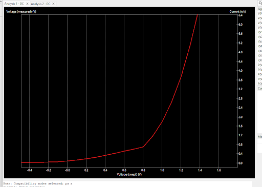

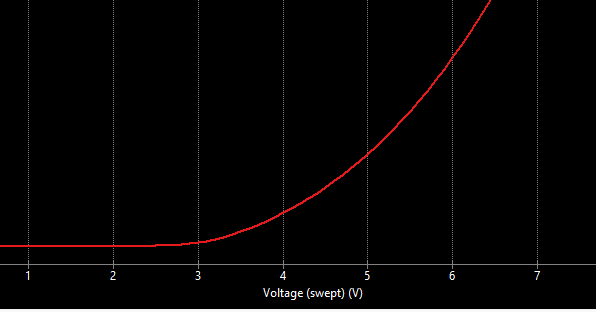

I have a subcircuit model that I’ve created to mimic the AimSpice level 16 model (poly-Si TFT) that I’ve been using for a while now. I recently updated from KiCAD 8.0 to KiCAD 9.0 which also moved me from ngspice 42 to ngspice 44. Once I updated, I quickly noticed that the subcircuit model I was using no longer works the same way that it did before - notably the devices turns on either earlier or later than anticipated (see images below). I tested the response separately using ngspice 43 and got the same response as ngspice 42. I tried to forced the matrix solver to be the same (setting SPARSE, reltol, abstol, vntol) - but this did not appear to have any effect. I also forced integration method to gear on both, and saw the same variation between the two versions.
My subcircuit model uses several conditional statements, and several comparisons of voltages where rounding could cause a change in the equation response. I can’t find any documentation, but did anything change in ngspice44 regarding the conditional (if) statements or how rounding is performed? I looked through the change list between ngspice43 and ngspice44 and didn’t see anything that would cause this effect, but is there another change that I missed or that might not be documented?
Ngspice42 simulation:
ngspice44 simulation:

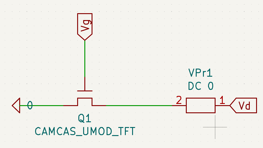

I’m unable to upload the full project, but I’ve provided the netlist below and an image of the circuit - it is a discrete device test for a transistor. The netlists being generated are the same.

That looks like ngspice44 is more accurately including the sub threshold behaviour of mosfets. They don’t just snap on as the Vgs reaches the threshold voltage.
Unfortunately ngspice44 is inconsistent, see image below:
In either case, I’m more curious as to why ngspice44 is responding differently from ngspice42.
