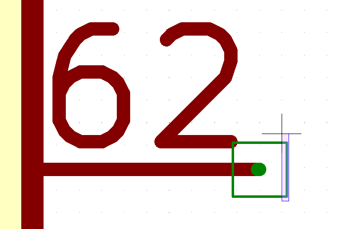

when I try to delete parts wich are close to each other I nearly everytime have big problems to delete them.
For example in the picture above I wanted to delete the green line. I selected the green one like shown in the picture. If I delete it afterwards the PA0 part on the picture gets deleted not the green line.
Is there a possibility to avoid this?

I Use version 5.1.4. Clicking on items dont work well when I have a schematic like shown in the picture. It always deletes the symbol. I tried again to delete the green line by klicking on top of it. Even if i click at the end of the green line (farest point from yellow symbol) the symbol instead of the green line gets deleted.
Maybe I wasn’t clear. You have to hover the mouse pointer on top of the item you want to delete. Then press Delete, don’t click the mouse button. Then you get the clarification menu. Select the wire there. It will be deleted.

Do not click on the small rest of that wire. Just hoover the mouse over it and then press [DEL]
That’s it.
It symply dosn’t work. I made a screenshot. It even dosent display the green line.
The center of your crosshairs is not on the green line.

Deleting off grid stuff in eeschema is tricky. Workaround: switch to a smaller grid.
I tried again with a colleague, but we didn’t find a solution. We tried all the ways which werde descriped in here. But it always selects the microcontroller. I think one problem is that I use the finest grid :grafik
I’ve lost track where this is at. You are trying to delete the green wire? Have you tried moving the chip or zooming ALL they way in?
Connectivity is determined in eeschema by pins sitting on a 50mil grid - that is why the standard symbols are designed that way. The recommended workflow is to stick to the 50 mil grid for your schematic and only change to a finer grid to find tune the position of ancillary details e.g. The exact position of symbol references, text, boxes etc. If you try to connect up a schematic on a finer grid you may find that your components do not actually connect.
Why don’t you just delete the MCU and associated dodgy trace and simply re-add it ( when you have reset the grid). Did you use a non-standard grid to layout the rest of the schematic? If do, you might be better to restart the design.
Or you could move (not drag which would rubber band the wires) the MCU off to the side so you can delete that wire stub, and then move the MCU back… Then keep to the 50mil (or 25mil) grid so you don’t get little stubs like that again.
