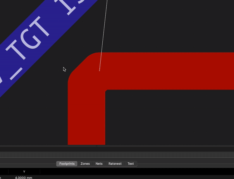

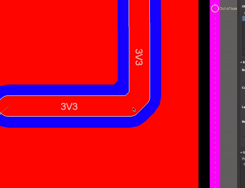

Changing edge / angles, see both videos:
corner 2
corner 1
This problem, you mention as an example, does not exist if the Interactive Router is set as @paulvdh mentions above.

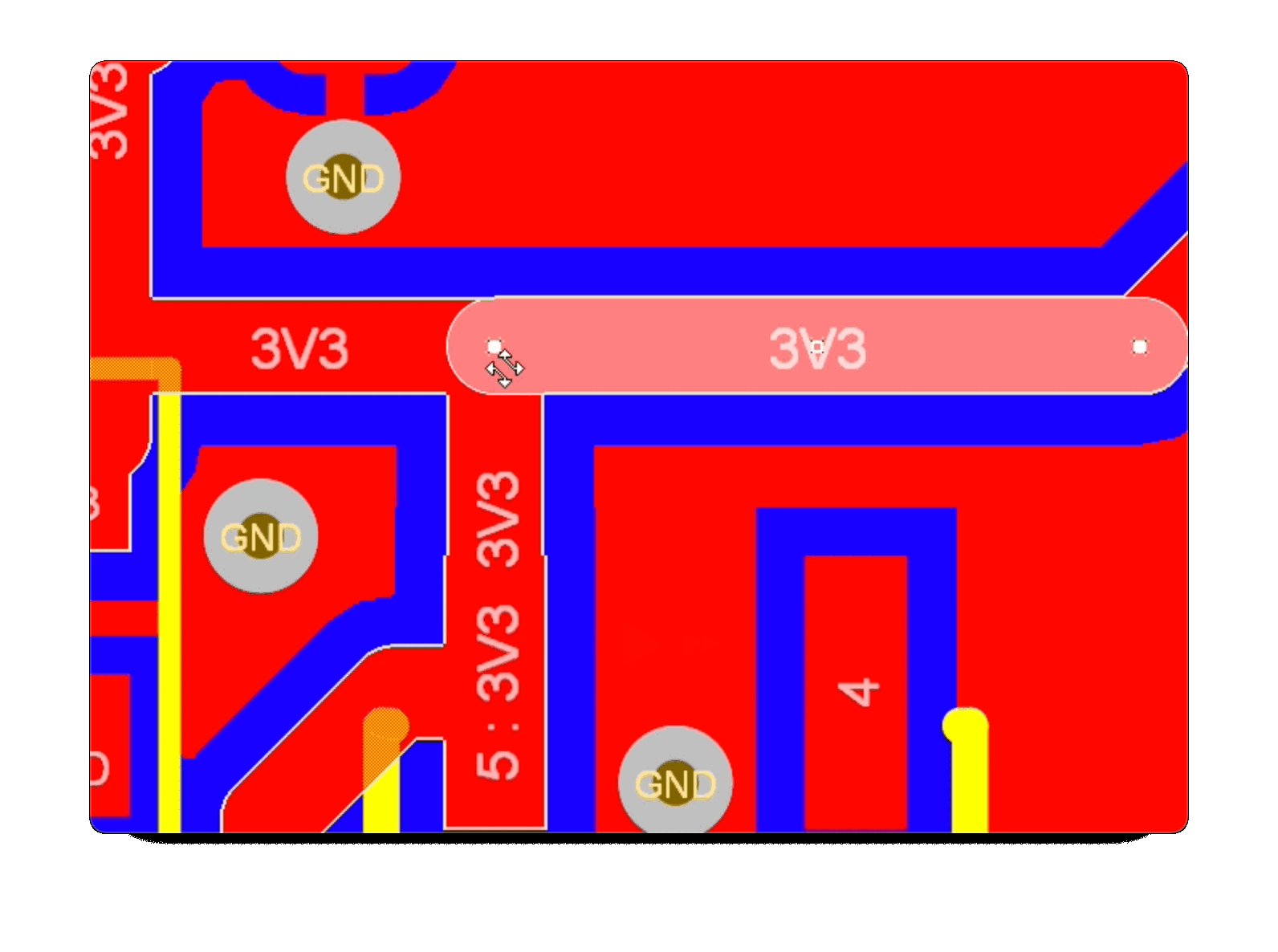

I’m not talking about a redundant track, just a track you cannot select because there are other nearby tracks. For example, I want to select this track (for whatever reason, eg change size) without the additional popup, just quickly using cycle-picking, is that possible?

In KiCad today, you have choices if you must select that edge: disambiguation menu, or drag-select (specifically, a left-to-right “enclosing” selection, as opposed to the right-to-left “touching” selection). The disambiguation menu matches highlight to mouseover, so you can quickly figure out the one you want. Neither are very slow, but obviously both may feel odd to a long-term Altium user:
My personal default seems to be a mouse click and swipe to select it.

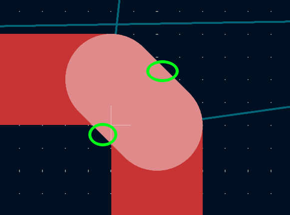

Even for quite extremely short chamfers cases like your first example, you can also get an unambiguous one-click selection by aiming for these two points. Which I admit is fiddly, but also how often do you really have such chamfers, anyway?
