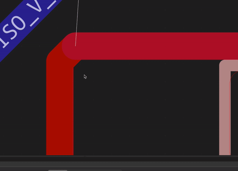

For 90° track connection using hotkey D I get following:
  • preserve 90° if moving mouse along one track,
  • add 45° segment when moving mouse along second track.
For connection with very short 45° segment (I am typically working with 0.1mm grid) I need carefully point on it to then D-rag it.
I am also not looking for an Altium clone. Altium had a huge learning curve and there are still lots of things I don’t like about it. The difference with Altium is that there’s virtually zero chance your requests or ideas will make it into a release. I had some ideas to optimize workflow / speed as well.
I like open-source in general, I contributed (ideas and code) to several projects.
Will post some ideas / questions here and if I feel comfortable, I will create a Gitlab issue.
The D hotkey helps at least! Instead of click-select > click-drag, D-drag is feeling quicker and smoother.
I only trying to get my head around where to click, it seems to change with the zoom level (I did put a bottom layer track behind to see where it overlaps)
d-rag

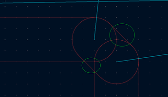

It’s more obvious in track sketch mode:
If you hit an area with no overlapping track, it doesn’t disambiguate. Aim for the triangle-ish areas in the green circles. Obviously, as the chamfer gets longer, this gets proportionally much easier.
It’s theoretically possible to have a special case of the selection logic in this case to prefer the tiny chamfer track more strongly. But that requires very careful implementation so as not to feel janky and inconsistent and also so as not to introduce excessive complexity or fragility into an already fiddly area of code.
There are blind spots, try it when zooming out a bit. Also D-dragging goes directly into chamfer mode inconsistently (sometimes the selection popup appears) when in the overlapping areas (or even outside on the horizontal or vertical line).

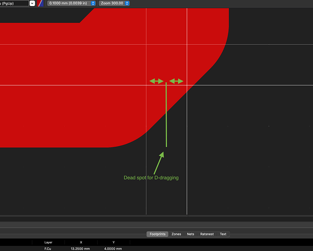

Actually I think there is still something weird going on, and it’s not the grid thing. I can also get D to fail to pick up the track in some places even on master, and with a tiny grid. I raised an issue for it:
I’m on 9.0.4 and the dead spots seems to be just on the half-grid lines (like those lines provide a dead spot when doing D-drag).
It was indeed a bug, but turned out not to be related to the grid (makes a change). Fix will be in 9.0.5 and the next testing and nightly builds if you want a sneak peek. In the mean time, stay a few pixels away from the H/V track ends and it won’t happen.
