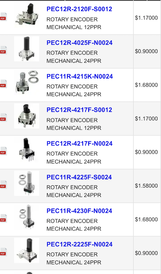

FYI - Not trying to sell you on the Bourns - just pointing out they are Low-Cost. Various configurations and price ranges from $0.9 to a couple of dollars (US), depending where you buy (Amazon, Digi-Key, Mouser…etc). (when checking price at Amazon, they often come in 6-packs). They are the choice of musical instrument/device makers because of their ‘Low-Noise’. Snippet of spec attached (shows bounce…)
They fit your geometry/footprint.
