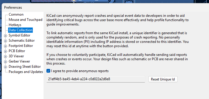

Do you have Data Collection enabled ? it helps the Developers track down crashes.
I do now. Thanks for that reminder.
If it crashes again, please file a bug report on GitLab and tell us what you were doing at the time, and what your data collection ID is.

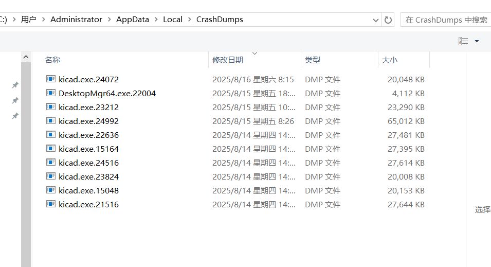

I have the same issues as you reported, but it still happens in 9.03 and 9.04. I installed WinDbg, but it doesn’t work. Are there ways I could send the crash dump files to you?
This dump file has an exception of interest stored in it.
The stored exception information can be accessed via .ecxr
(5e08.1324): Access violation - code c0000005 (first/second chance not available)
For analysis of this file, run !analyze -v
