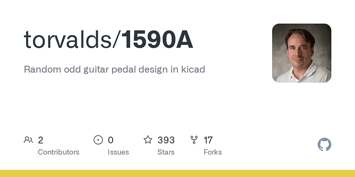

BTW, the Linus Torvalds registered on Gitlab and reported a KiCad bug yesterday:
Apparently, he now tries his hand on hardware design, too:
Didn’t see that one coming!

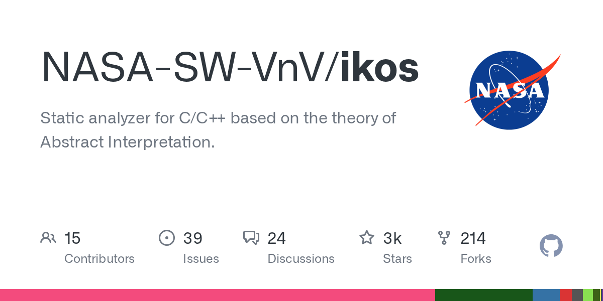

For example, can we improve quality by using tools like these?
There seem to be a lot of other tools out there. I wonder if they’re not being used in this project?
Btw, this forum is not the right place for this kind of discussion. Devs do not show up here by default and it is not helpful information about the USE of Kicad.
