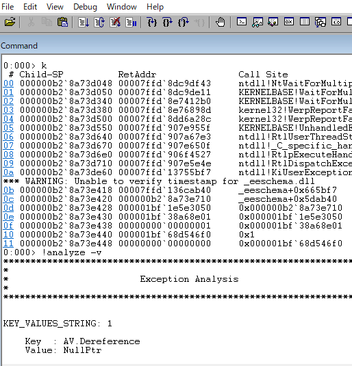

I’m testing it on old PC with Windows 10 64-bit which I keep for such experiments. I tried deleting all KiCad-related directories in /Users/, but it didn’t help. That’s not suprising, because they were already empty, as I uninstalled the previous version with “remove config files” option. I tried installing today’s kicad-nightly-9.99.0.2590.g9fcee70827-x86_64.exe and it doesn’t run either. Windows crash dumps say the problem occurs in kicommon.dll.

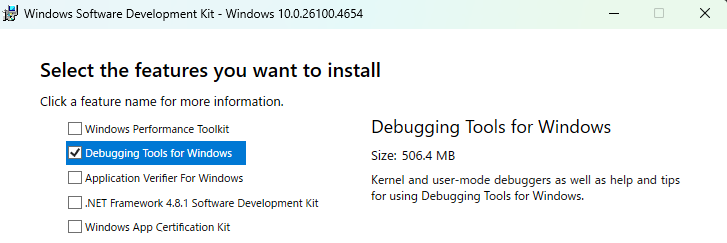

If you get WinDbg and provide the traceback information of the crash dump, you can visualize the sequence of function calls and the cause of the abnormal termination.
Install only WinDbg from here. (Win10) Windows SDK - Windows app development | Microsoft Developer
Select the file saved in the %LOCALAPPDATA%\CrashDumps folder with Open Crash Dump and run the following command to get more details:
k
!analyze -v
