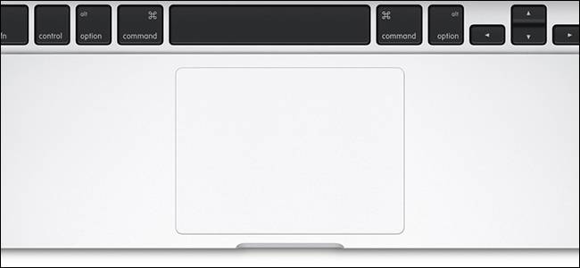

On OS X, the ā€œcontrol-click to right-clickā€ convention is only supported on the default canvas, and not on OpenGL. Also, the scroll bars disappear in OpenGL mode. So, OpenGL mode requires an external mouse, while the default canvas can at least be used with the trackpad, even if it’s a little awkward.

Isn’t right click emulated with two finger click on the track pad? (Why the ā– ā– ā– ā–  are there no buttons on a mac? Is it cheaper or do some people think buttons are ugly?)
Using any CAD software without a mouse is an interesting approach. I could see it for only viewing the result but not for working on the board. (Not precise enough.)
But again maybe having an alternative way of scrolling might be a good addition.
In the meantime there are options to emulate middle click: (Not sure if it can be used to move around in open gl.)
Yes, thanks! I knew that at one time, but I’d completely forgotten about it. All native Mac software recognizes control-click as a right click, though.
Apparently Apple thinks that two buttons would be confusing. In any case, it’s been that way since 1984.
I started out using the trackpad as I was first learning KiCad, and I was frustrated by the fact that it does not support the standard gestures (two fingers to scroll, and pinch to zoom). However, I got pretty far with it, and it was only when I tried using the push-shove router that I realized that I had to have an external mouse. But yes, now that I’m using it, the external mouse is easier and more natural.

Just go to Preferences and activate ā€œUse touchpad to panā€. You will have standard 2-finger scroll and pinch-to-zoom on touchpads or pan with touchpad on Magic Mouse.
But, you have to activate it individually for each application.
Thanks, that is awesome!
I tried it out and it seems to work great in eeschema and pcbnew. However, neither the library editor nor the footprint editor have a ā€œUse touchpad to panā€ in their preferences, so two fingers still zooms in those applications.
Library/Footprint editor use the setting of eeschema/pcbnew (they are no separate applications, but only special instances).
I just tried with my last nightly (I build myself but without modifications in that area) and it works also in library/footprint editor.
What version did you use? Might be a bug…
Edit:
I forgot… you probably have to restart once so that library/footprint editor pickup the change…
Thanks! Restarting did the trick for me.
