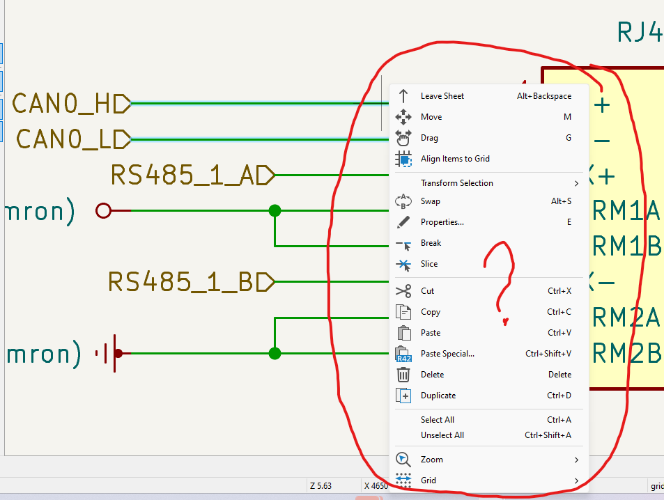

In KiCad v9, you can assign a net class to a single net, but you can’t assign multiple nets to the same net class. Why is that?

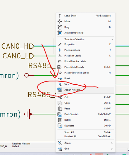

in single net;

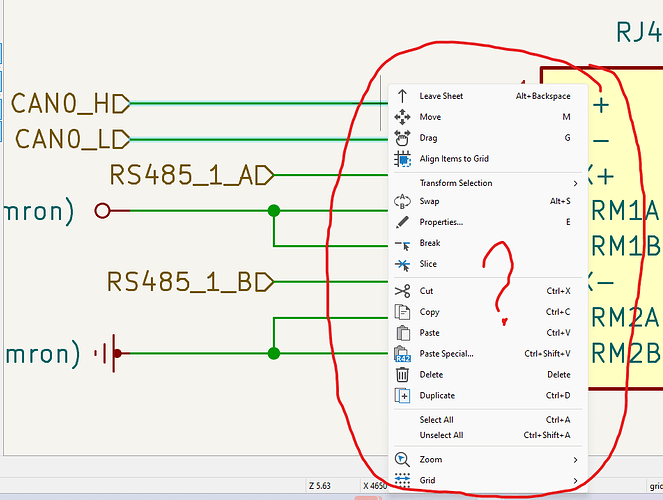

in multiple selection net;
Probably because it’s not possible to select more than one complete net . . . when the Net class is assigned the complete net is highlighted not just the segment of the line.
Well, can’t we make an innovation in Kicad so that we can select multiple nets and assign them to netclass?

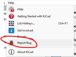

Sure, you can ask by using the “Report bug” facility and titling it as a “Feature request”, supplying all the needed info and describing the feature you want added . . . when you are done, post a link here so other users that would like the same feature can vote for it. :+1:
Well,
i added an issue;
It’s been closed . . . you have to do it with all the included info, the easiest way is from “Report bug” in KiCad Help as I explained earlier . . .

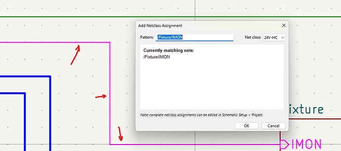

@Muzaffer_Nizam This might be what you’re looking for: rule areas
I know this feature. It is good for block nets but it is not usefull in Power circuits.
Solution :v:t2:
This feature added to Kicad v10 as a below link;
