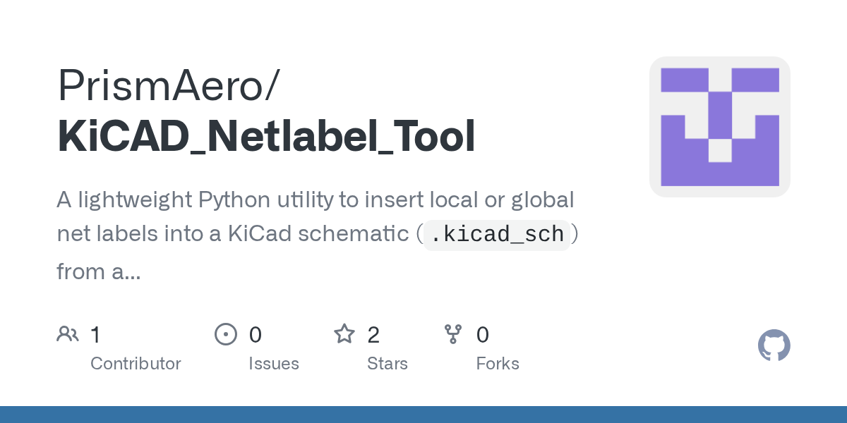

Hey Everyone,
I got tired of manually typing out net labels in KiCad one by one, so I threw together a little Python script—labelgen.py—that automates the whole process from a simple CSV. It pops up a quick dialog (backs up your schematic, lets you pick mil/mm and local/global), then reads your “Label” column, uppercases everything, and drops each net label at the top-left outside the title block. No virtualenv wrestling— it even auto-installs its one dependency.
Figured it might save someone else some time, so I’m sharing it here. Feel free to grab it, try it out, and let me know if you find any quirks or improvements!
